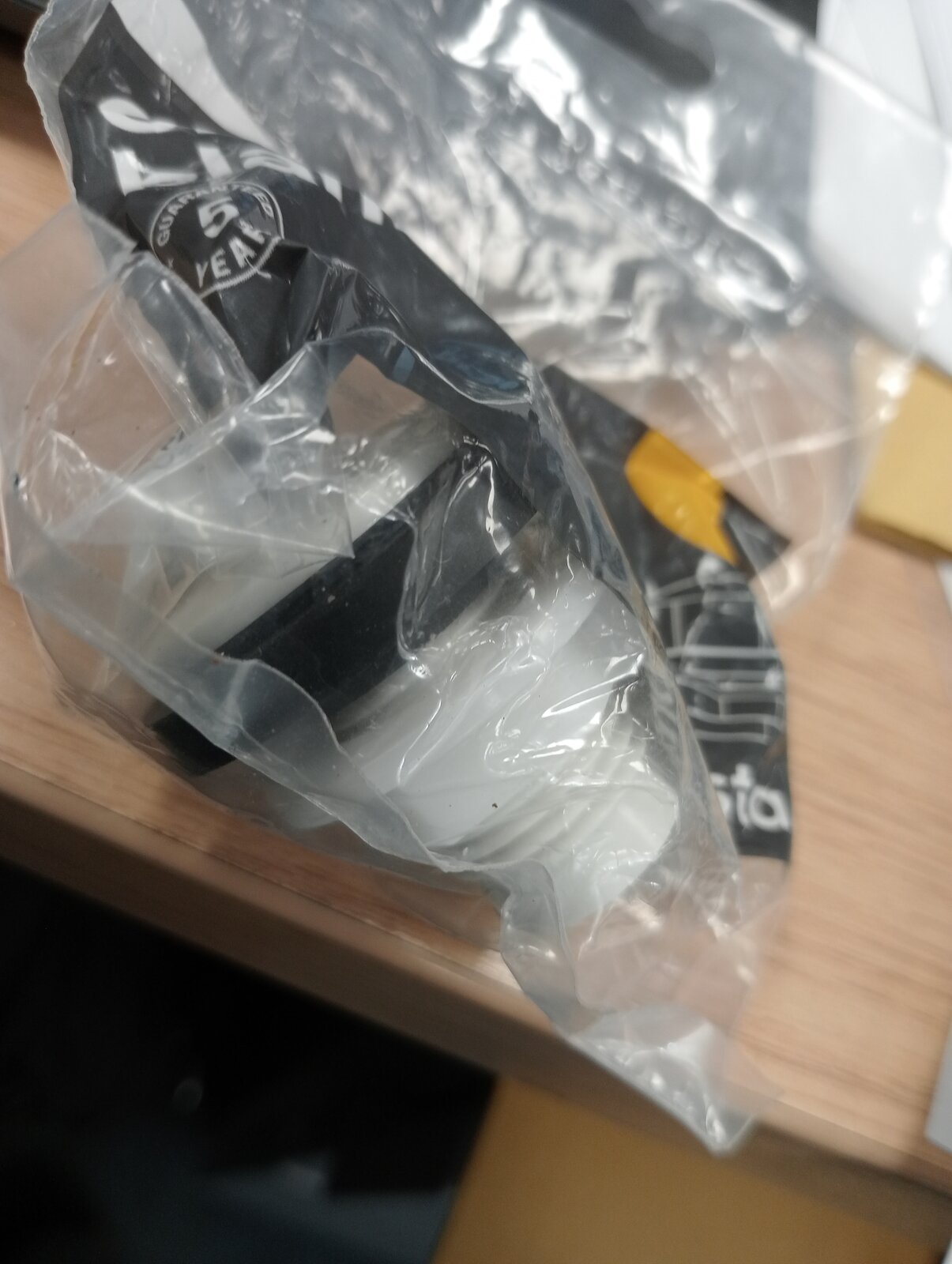

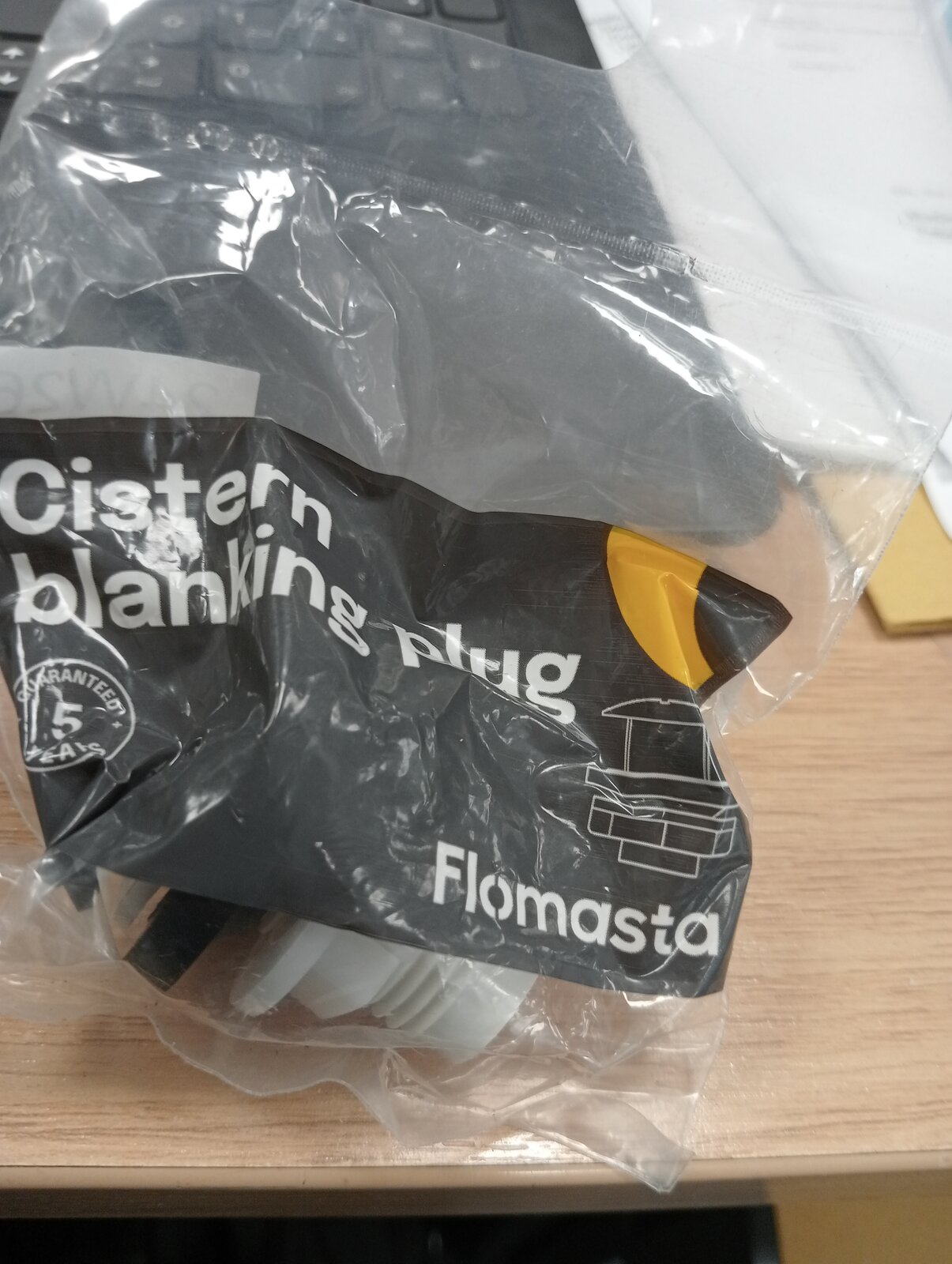

Over flow drilled above fill valve
Nah, shouldn't need that. Just ensure the rubber seal covers the hole properly and that it's nice and tight. A little line of silicone on the back if the hole's bigger than the shank of the blank, just to fill the gap before the nut goes on and that should be enough.
Thanks I got this
Absolutely not - as long as the seal covers the outside of the hole completely on the inside of the cistern and the surface is clean and the plug tight enough then there shouldn't be a concern. That and the water shouldn't ever get there anyway, as it'll reach the overflow first.

Yes I feel competent to do it. Just wondered the best way as obviously installed wrong. Even thought of just putting a double check on the cold feed to the inlet and putting a part 2 full valve on. As this would protect to fluid cat. 3
