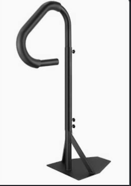

I have a an adjustable steel hand rail ….
This is 2” steel tubes which have a Matt black finish ….I think it’s paint, as no flaking which happens with powder coat. Photo of new item attached.
It was supposed to be for outside use for Hot Tubs …. In less than 9 months it’s rusting significantly, and it’s under a hard roof ….. presumably not fairing well to coastal salt air.
I need to overpaint it, can abrade to give a key, chemical clean ….
Anybody recommend a pain finish to apply?
Needs to be in spray can …. To get even smooth cover.
Should I use some primer, or barrier coat.
Thought of : https://www.halfords.com/motoring/p...-paints/halfords-matt-black-500ml-258771.html
Another option might be Hammerite smooth spray … would work on bare metal parts & and rust
But happy to know if something better.

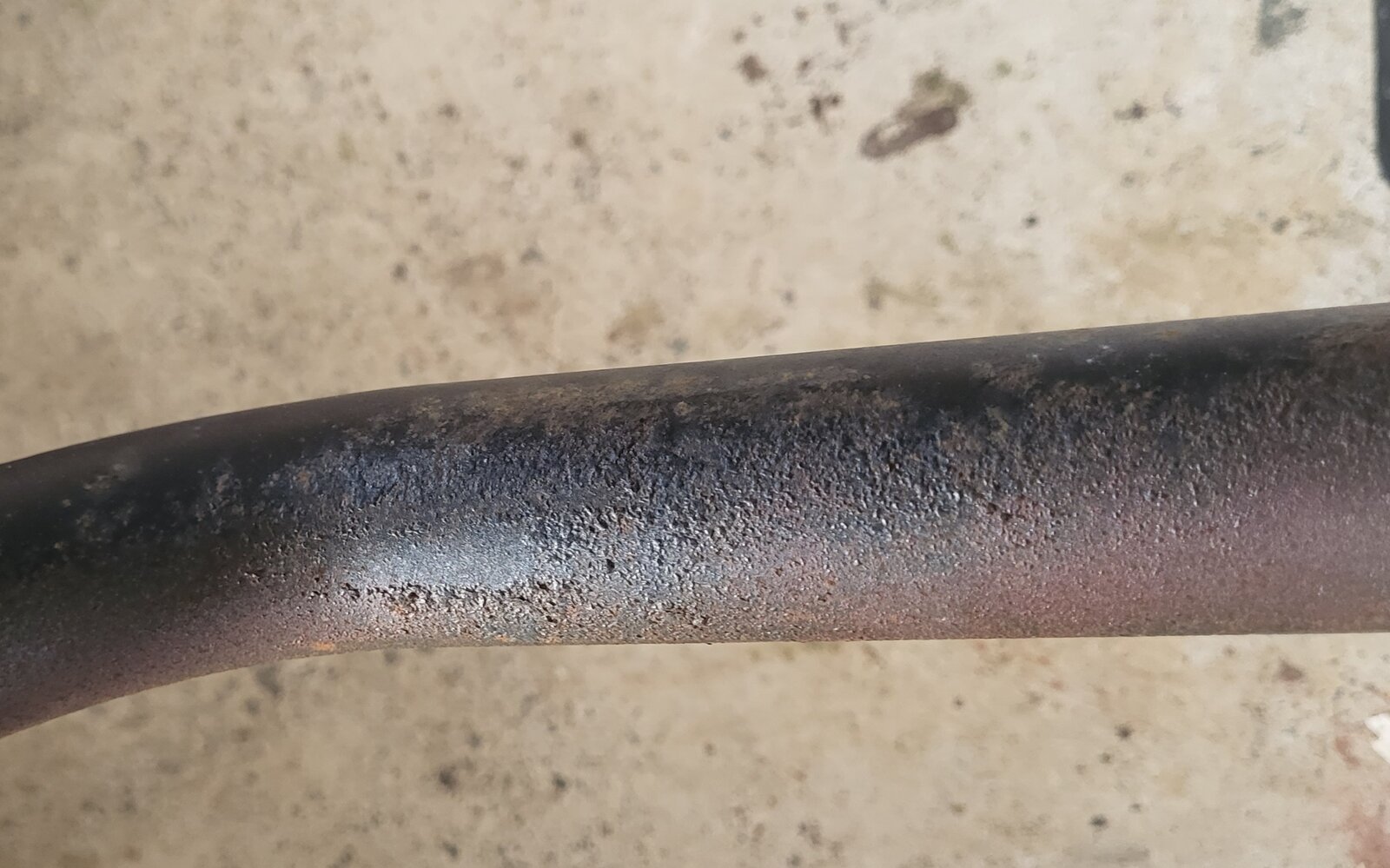

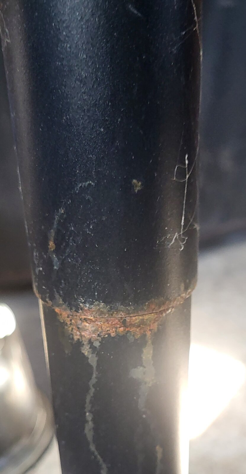

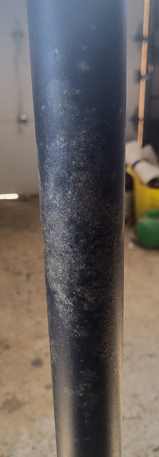

You shouldn't need more than one for this job. How corroded is the hand rail? I thought you just had a bit of rust rather deep extensive corrosion at this point?
Can you put some pics up of the rust please?
3 pics of worst parts attached.
Less than 5% of the whole.
