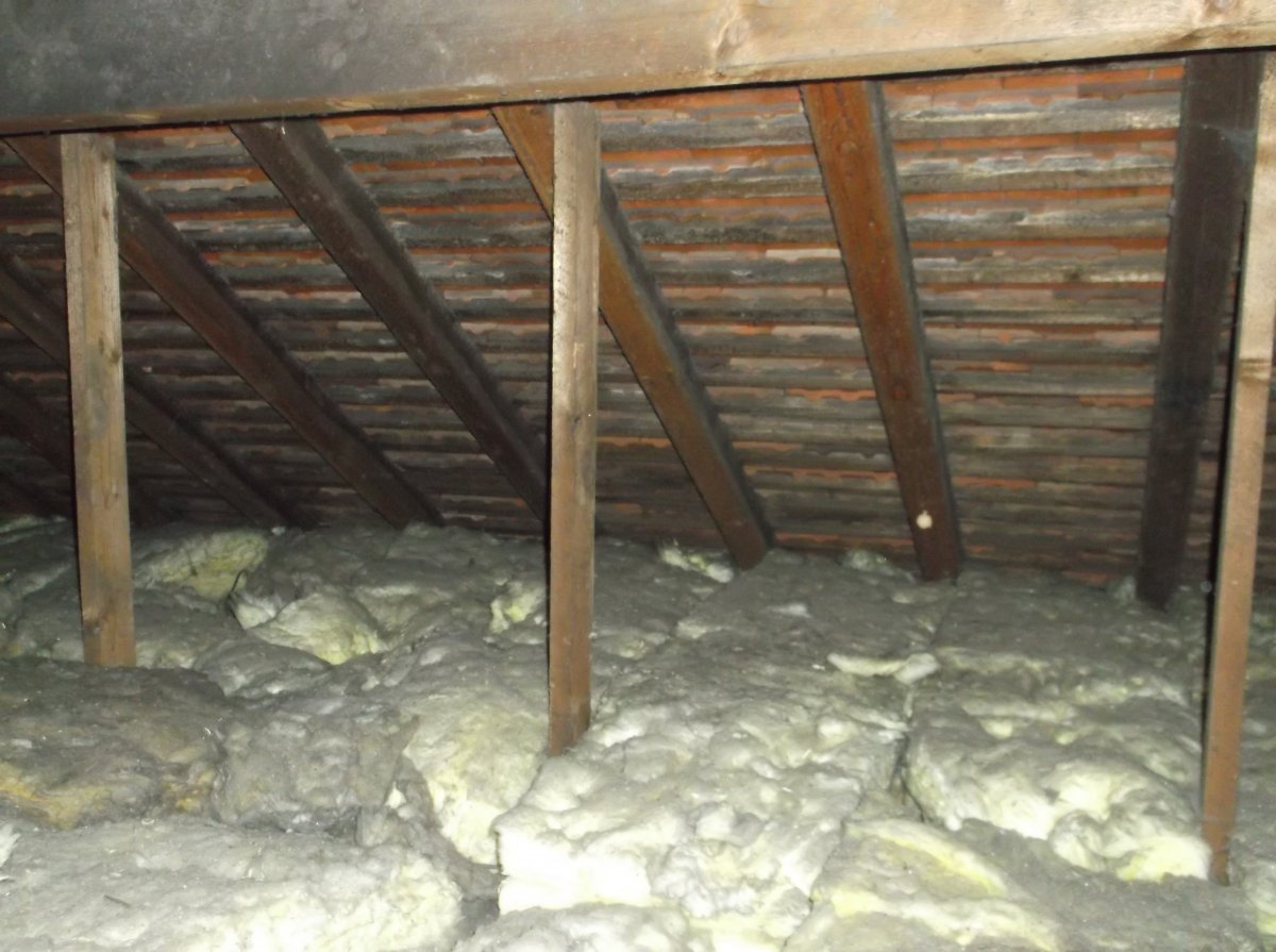

In traditional cut roofs, ceiling joists are often supported by having a binder (eg a piece of 100x50) running across the top of
them roughly at mid span, and nailed or screwed through. The binder itself is then supported by timber strips (eg 100 x 25 - sometimes they would use any old bits of scrap, such as lengths of floorboarding etc) nailed up to either the ridge or a purlin.
The loads are not high so it's a case of just preventing excessive bend in the ceiling joists.
Typical old roof - can't see the ceiling joists and binder, but you can see the strips supporting the binder off a purlin.
Thanks Tony so that may be my best option, I'll discuss it with building control
