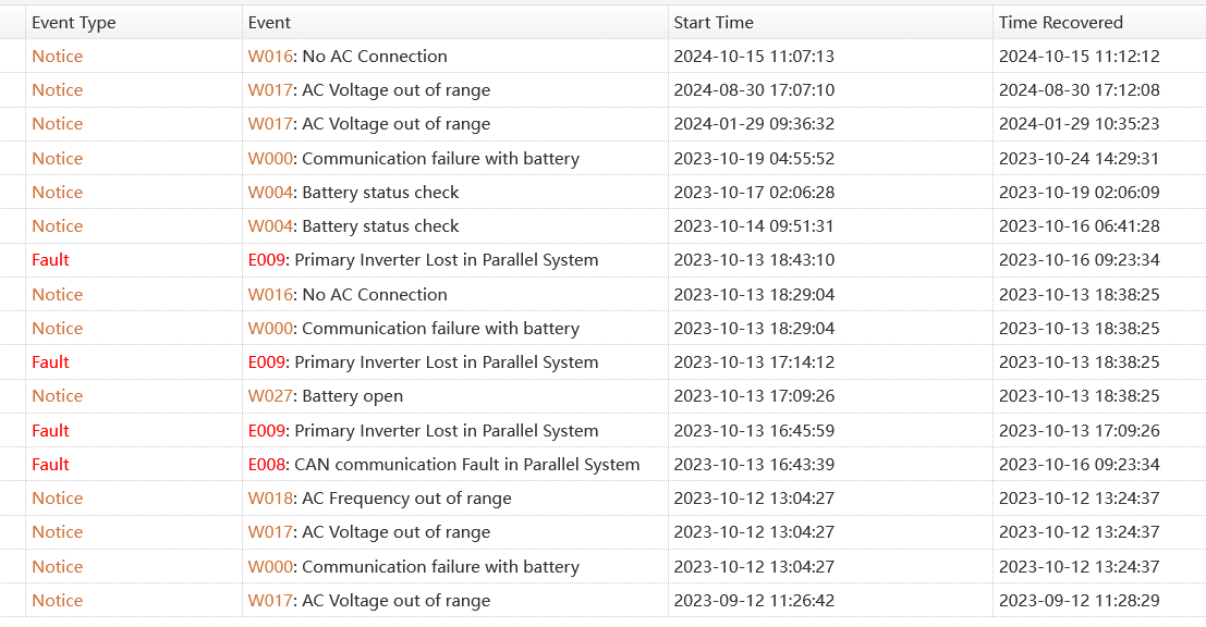

My solar panels display the voltage on the app,
it does not seem to have ever fallen to 230 volt, but neither has it ever tripped out the panels on over voltage. It does list when some thing has gone wrong.
In the main the dates con-inside with when I had work done, I would say AC Voltage out of range is a brown out, not over voltage, But since all recorded best ask the local with solar panels how often they trip out.
