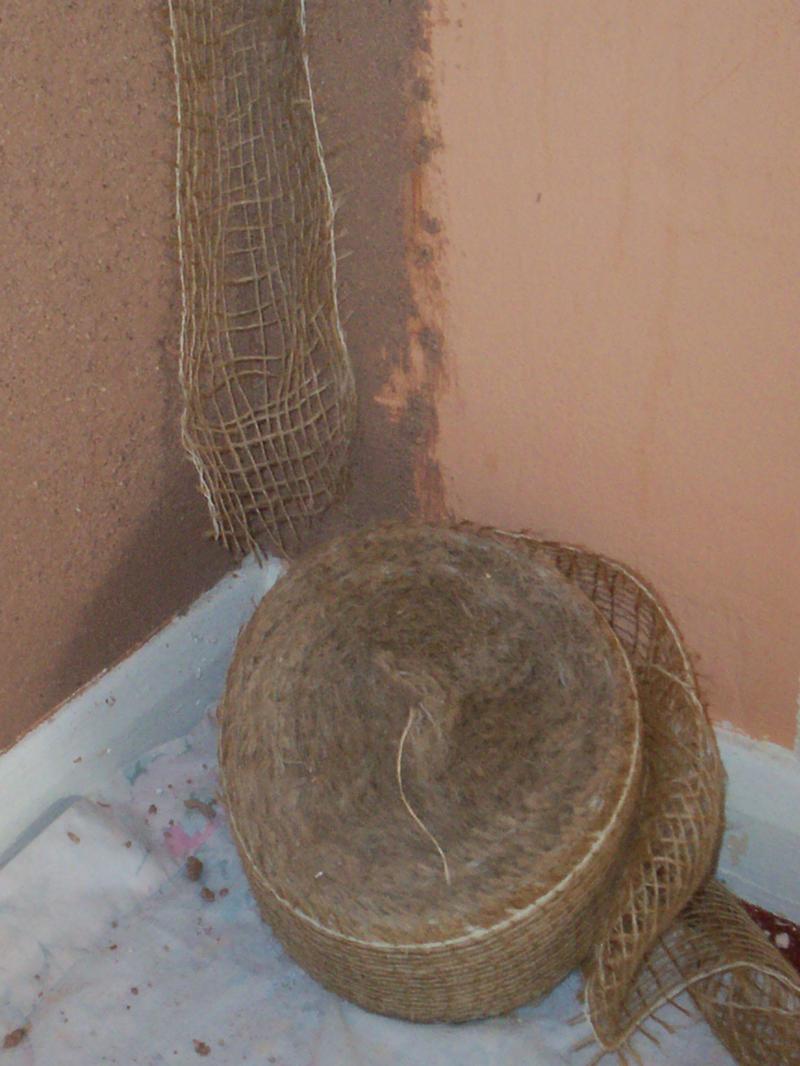

Don't use paper tape if your skimming. Use either GRP self adhesive or old style jute hessian scrim; not many use that stuff these days but there are still one or two about. :LOL: ;)
What about the white cotton scrim?
Now that and jute scrim was all there was when i first started plastering. I don't know whether you can still get it nowadays. I knew it as "bandage scrim", because that's what it looked like. It came in rolls,, 2"x 100yds.
Ps,, I've just Googled "bandage scrim" and it is still available. It came up as Cotton Scrim.
