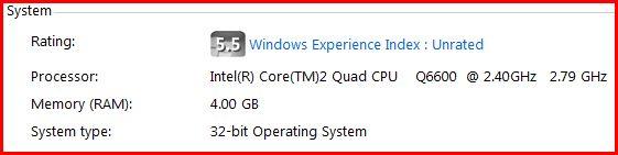

I may be wrong but my understanding is that device manager merely reads the CPU identifier burnt into the chip - if manufactured as a 2.4GHz this is what will be displayed, regardless of overclocking.
Mine shows the actual manufactured speed of the CPU and what it's set at. So the CPU is 2.4GHz but overclocked to 2.79GHz.
when ive put up the device manager to show the spec of the pc it shows them as 2.4 ghz. should it not show it as 3.0 ghz?
Same here, my cpu is listed at 1.8Ghz, but under the general tab in system properties (My Computer>rightclick>Properties) it's shown as the correct OC'ed speed of 2.43ghz
