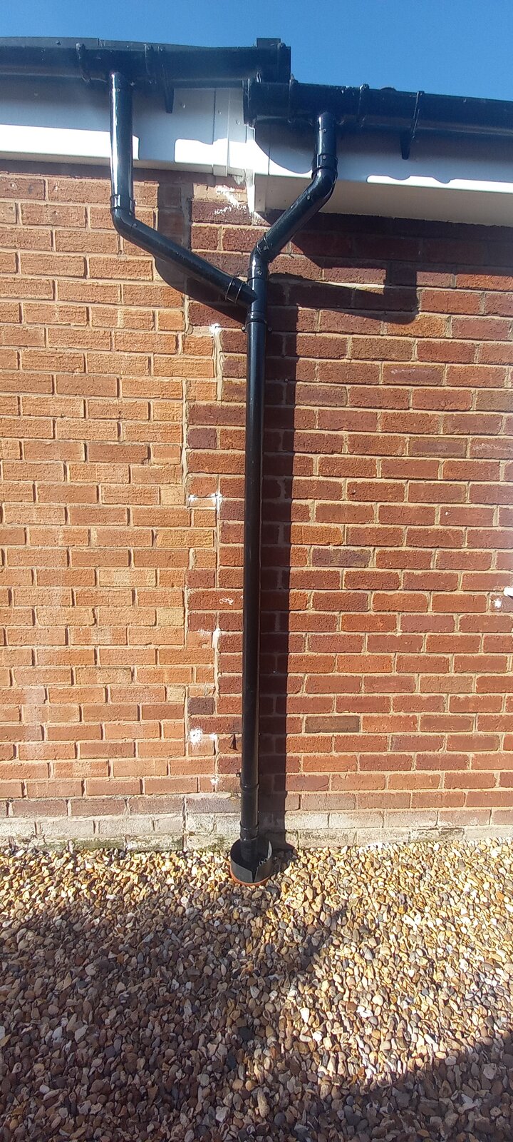

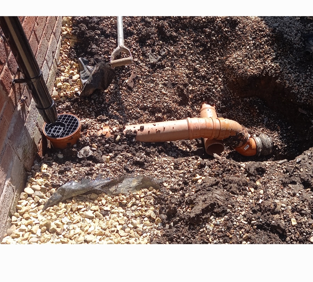

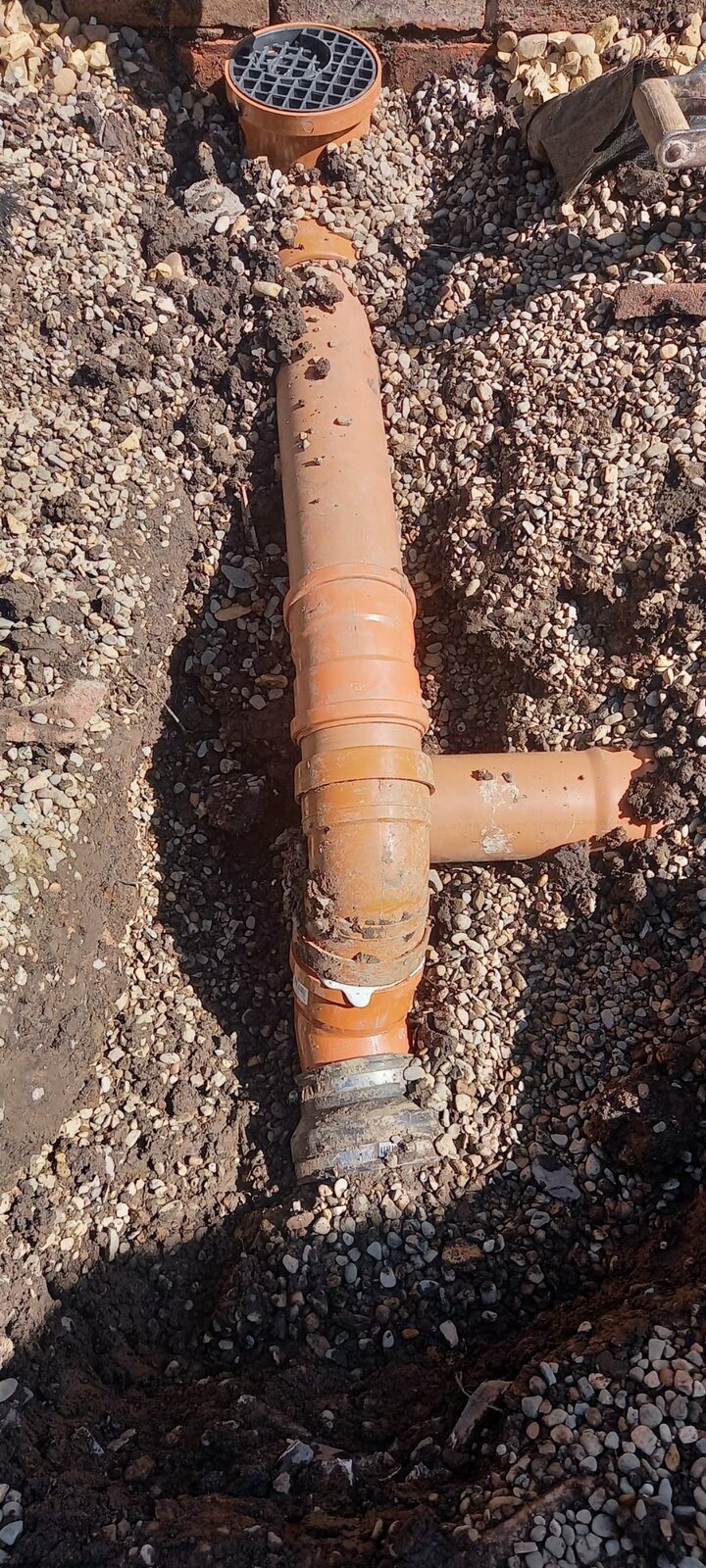

Here are some photos. I've tried putting an endoscopic camera down to look for any issues but the bend where it drops down underground presents a challenge I can't get past.
It is worth stressing that a lot of water comes down there from the flat roof and two sides of the main roof. I wonder if it is some strange pressure issue? As I say, works fine as soon as I remove the insert and continues to work fine once I put it back in - with continued flow from downpipe.
