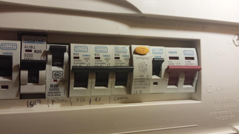

Every time we use an microwave oven along with the oven and plasma Tv, it trips the fuse.

Are you sure it's an RCD that trips, or is It an mcb. They are two very different things! An RCD will have a test button on it.
What markings are on the device that trips, it may say something like b20?
Sorry not sure if its RCD, but in the consumer unit, it trips when something is wrong.
Overload is unlikely with the appliances you refer to. More likely a substantial, intermittent fault if it is only an mcb tripping.
If it is an RCD then it could be an intermittent earth fault or an accumulation of normal leakages and an over-sensitive RCD.
These are what you/we are looking for. You will see that the RCD/RCBOs have test buttons.
If you have an RCD/RCBO that is tripping when on load, it is highly likely an appliance fault. I would generally point the finger at appliances with heating elements, such as microwave and ovens.
It could be that when they are on individually, that the earth leakage is not greater than the 30mA and not enough to cause a trip, but when on simultaneously it is.

The microwave oven is built in. When it's on by itself, without the electric oven, it's ok. But when used with all three appliances, it trips.
BG MCBs are about £3-£4, so why is there mixed breakers in this board?
They are supposed to be type tested, who put them in?
Here is the photo. It's the switch 3rd from the right.
Go on tell us which circuit it is? 3rd switch from right could mean a number of things, depending on what your interpretation of a switch is?
Is 32A MCB marked F/F (I assume that is first floor and not fridge freezer?)
or possibly the one with the yellow test button?

Go on tell us which circuit it is? 3rd switch from right could mean a number of things, depending on what your interpretation of a switch is? ... Is 32A MCB marked F/F (I assume that is first floor and not fridge freezer?) ... or possibly the one with the yellow test button?
I imagine neither. Since we're talking about something which trips only when the cooker (and other things) is on, I would imagine that the B32 labelled 'Cooker' would be a good bet - and that is, indeed, the 3rd 'switch lever' from the right (at least, by one way of counting :) ).
