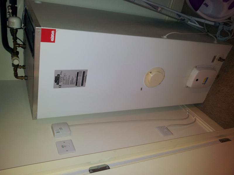

Hi All
Please forgive my noobiness as I don't really understand much about plumbing etc.
In my flat, I have an Elson Coral E MF 150 litre immersion water heater, and since the start of November, we are getting no hot water overnight.
I've lurked around these forums a little to try and diagnose the problem myself, but my boxy heater looks really different to the more dome top immersion heaters others have.
Things I've checked so far:
* Boost heating is working fine, we stick it on for 2 hours odd every day now.
* Tested our overnight storage heating just in case there was a general problem with Economy 7 electrics, but this works fine.
* Checked our electricity box, and everything seems to be in the right positions
* Curiously, where our off peak switch is in the area near the water heater, red lights appear above it to show that it does trip to Economy 7 mode around midnight, but the immersion heater unit remains cool and makes no noise.
Based on the above, I was just wondering if any of you nice folk have any recommendations, things to try, parts needed, and/or plumbing recommendations (N9 North London area)? It would be so very much appreciated!
Thanks a lot for your help!
-J

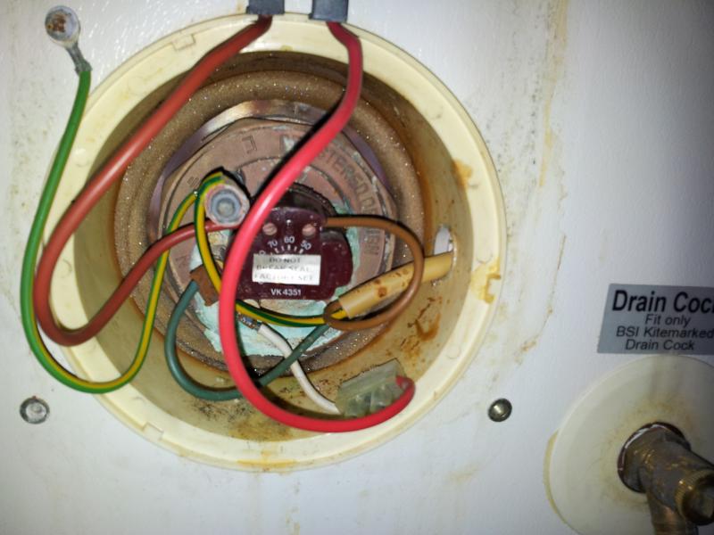

Since writing this, tonight our overnight heating has completely conked out now :( I pressed the reset button and this just stays stuck in position, but the heater is not making its usual noises when its meant to kick in around 1am. I had a look behind the cover and don't see anything obviously wrong, slight buildup of scaley stuff I guess and one rusty screw where the green wire is. I have attached a picture of it, not the two red wires going out of the picture above are connected to the reset switch. I was wondering if this looked normal to you?
I also finally received a quote to replace our boost immersion heater which is approximately £200 for parts, and labour for first hour, about £80 for every subsequent hour spent. Does this sound reasonable for the job or am I being ripped off?
