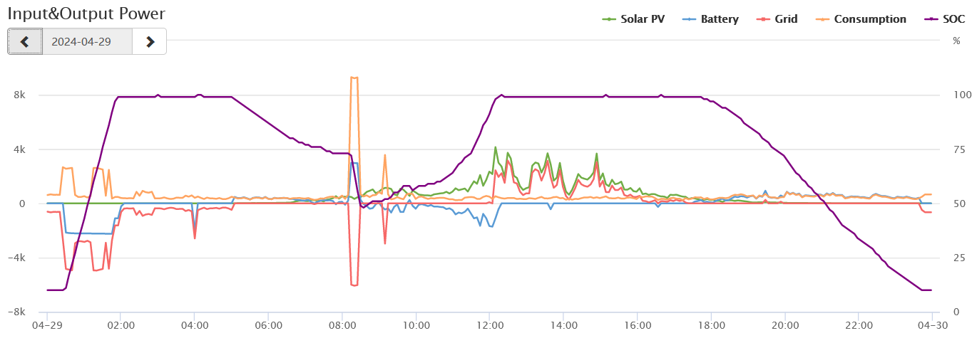

Not sure if an OWL monitor shows kWh or just kW, but yes you can measure how much power is being used, I have both plug in and clamp on monitors, however there accuracy is some times questionable. For 29 Apr 2024 British Gas App says 7.72 kWh my solar panel software says 8.8 kWh and neither can give my price, as power midnight to 5 am is different price to power 5 am to midnight.
This 1714588907570.png is what my solar software shows me, I also have a graph 1714589146878.png but although it gives one an idea what was used when, it can hardly be used to work out a bill.
