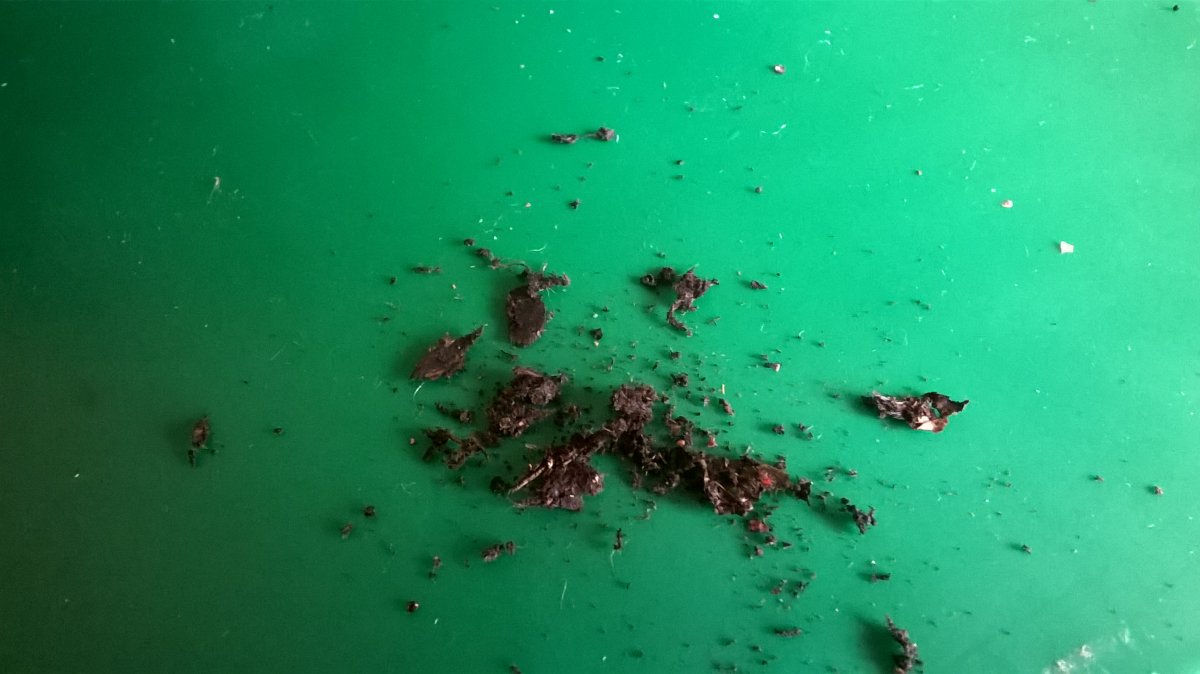

Packed crud and grease or remains of a fibre washer round shredder drive shaft
Min
27 Oct 2003
292
7
Thanks to good advice the shredder hopper is mended and reassembled :)
But while I've got the business end of the shredder open, thought I'd inspect the drive shaft.
There's a recess round the drive shaft that is partly filled with something. Can't work out if it was a fibre washer, or grease that's got packed with crud.
I have zero experience of these things, so don't even know if you'd get a washer here.
Should I just dig the stuff out and replace with general purpose grease?
Here's a pics of the recess and some of the crud that I've crumbled up.
Thanks folks
From what I can see, there are some aluminium shards from the slab cutter shaving it's end plate - that's normal enough - and a perfectly good grease seal so I don't think there's a problem there.
Exploded diagrams are available at diyspareparts.com which could help!
John :)
Thank you John.
All re-greased and reassembled, and blow me - it works. And diynot.com rocks as a community of experts that's saved me from having to trash this much-loved shredder.
