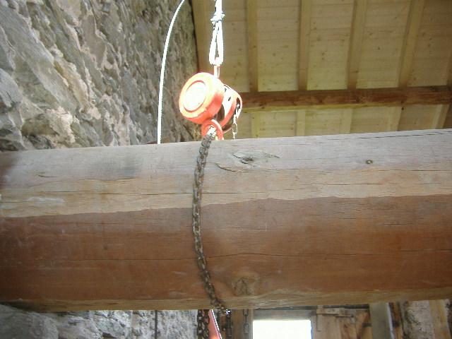

Blagard
This doesn't really do what you want as it shows the beam just after I had removed the wood :(
The beam is 370 x 400 x 7000 and sat perpendicularly under a 9 m truss supporting the roof. Originally the beam-ends sat on two crossed layers of timbers ( maybe 80 x 80 from memory, but essentially what was lying around I guess)
Barn built around 1840 I believe.
I don't know if it's of interest, but I asked the locals how to replace the wood and they said concrete, so this beam now rests on a pad 400 x 500 x 100 (deep) in the stone wall.
