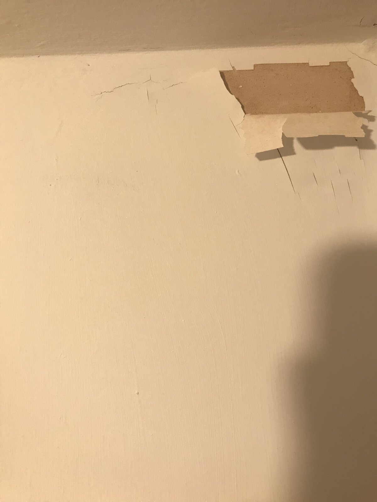

Hi.
My house was built 2016. A small corner of my bathroom has paint flaking off and plaster is now exposed.
I have attached pictures.
my questions is how do I repair this?

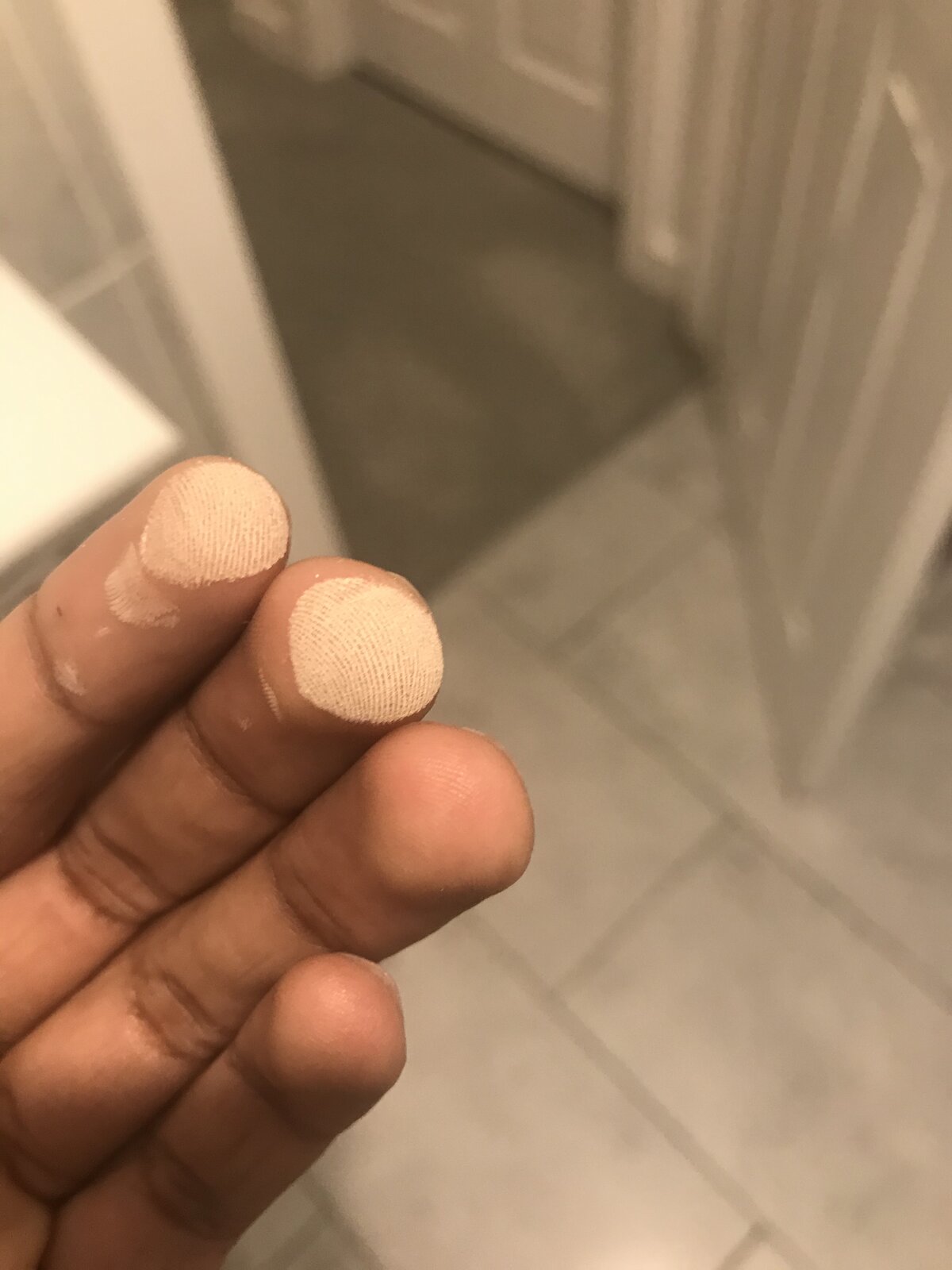

when I touch the plaster. A Plaster coloured dust comes off. Is this normal?
I would be grateful if anyone can provide step by step instructions with any recommendations of products.
From some research I just need to sand the area and apply a deluxe plaster sealer? Then paint over it

Looking at your picture it would appear that a mist coat wasn't applied before painting. If you took a scraper to that paint I think it would come off in sheets. You will have to remove what's loose before preceding

thank you for your reply.
once I remove all paint that comes off.
Do I just use a plaster sealer?

Primer or a decent mist coat, as it's a bathroom get a decent bathroom paint too to finish off.
Is the bathroom ventilated enough?

that is a good question. It does have an electric fan extractor. And I ensure to open windows after a shower as well. I will need to keep an eye out.
In regards to the plaster dust. Can I just remove with a damp cloth?
Is deluxe easy care good enough? It says 5 year anti mould and says it’s steam resistant
