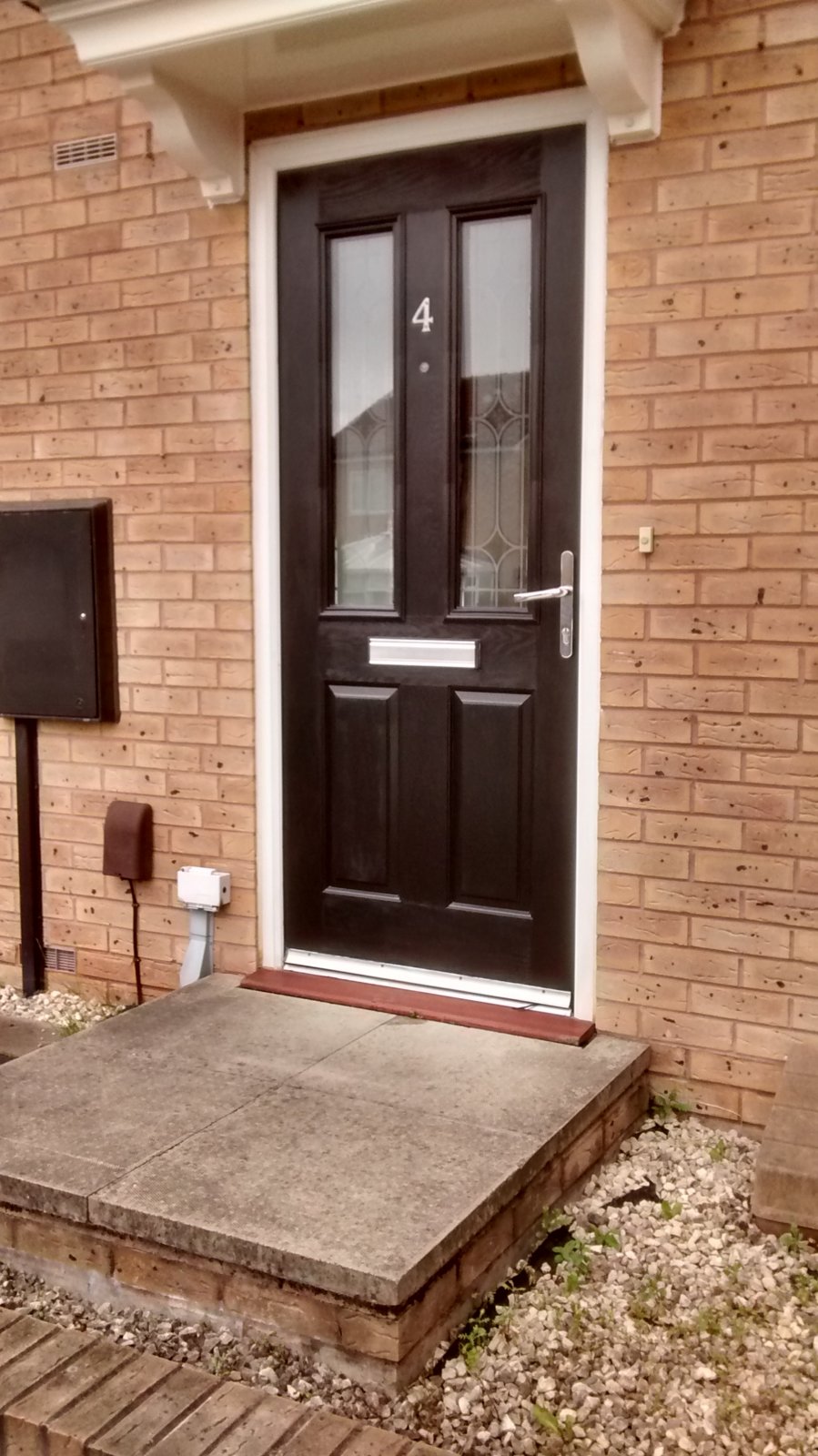

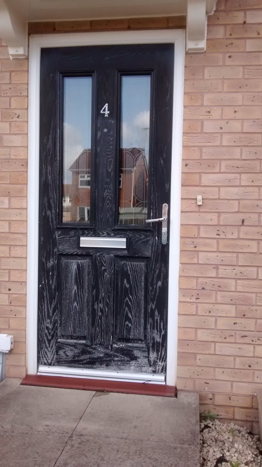

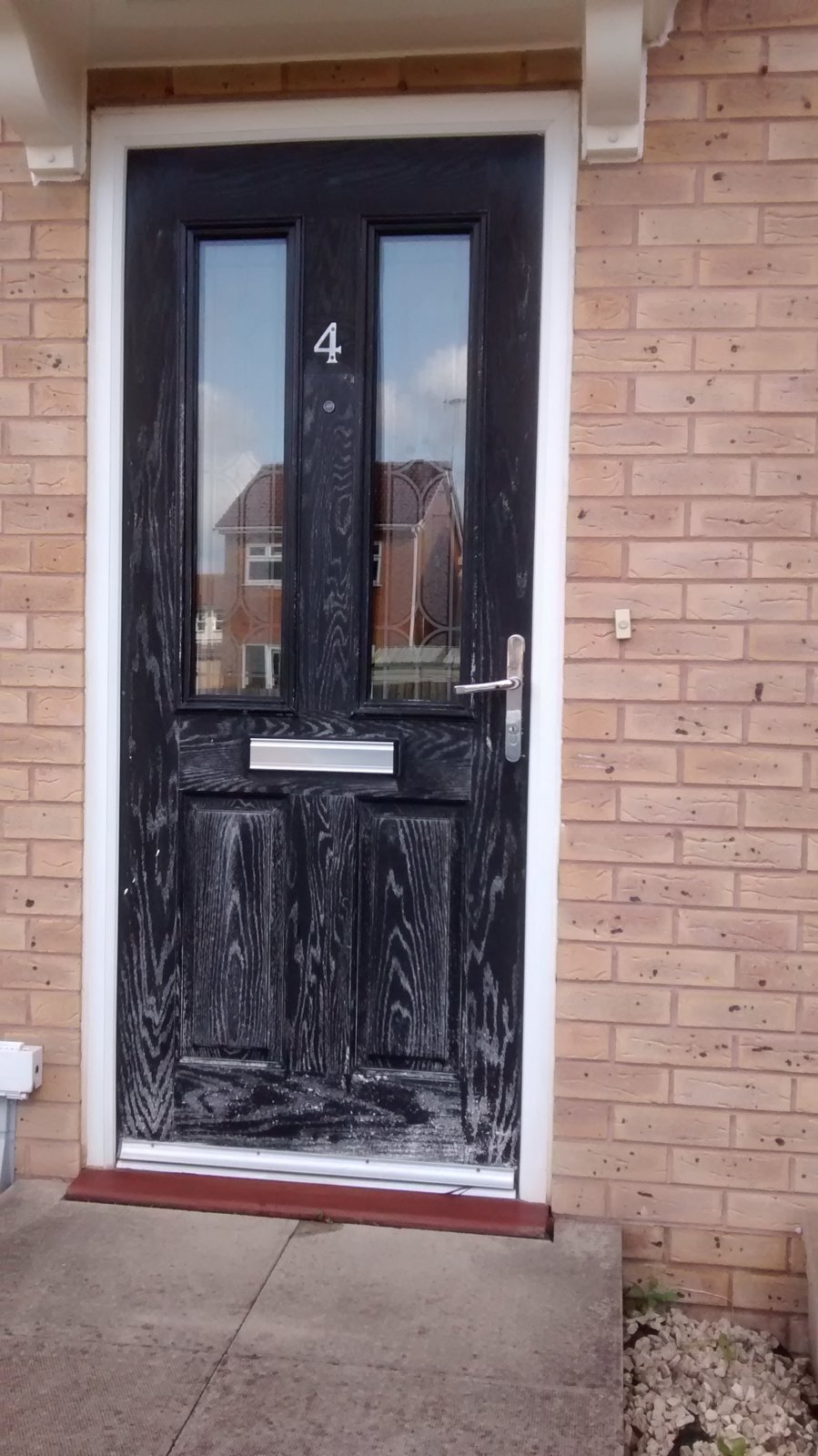

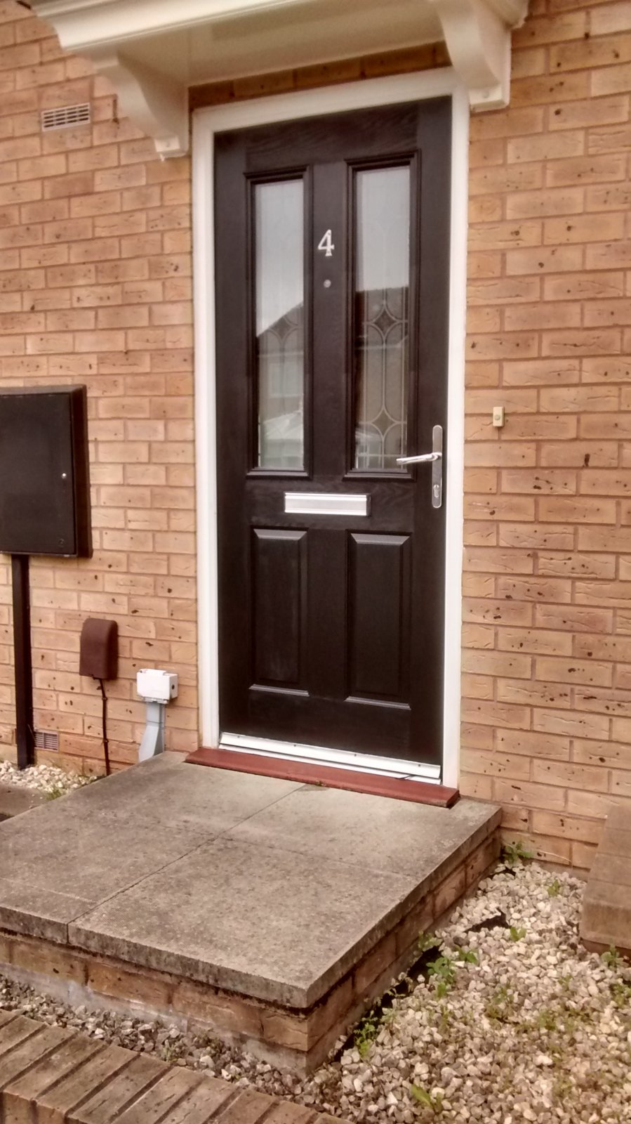

You won’t regret it. One of the easiest paints to work with which needs no primer or undercoat. I just gave the door a very light sanding (took all of 10 minutes), brushed off the dust and gave it the first coat. It covered really well, but the second coat brought out a great finish. Work quickly but don’t put it on too thick. I used the satin finish but gloss is available. If you go to a decorators’ merchant you can get it tinted to any colour too.
Good luck
