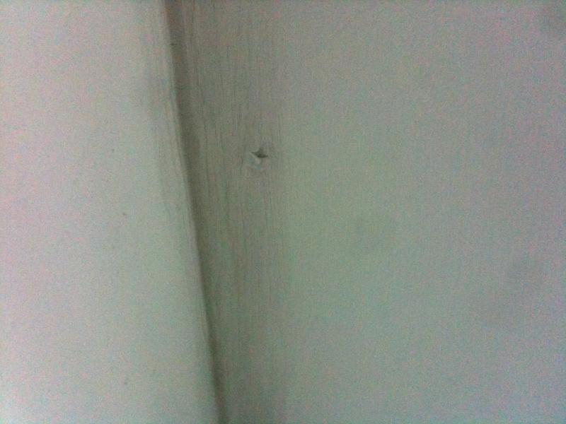

I've boxed-in some pipes in our kitchen and put a bead of caulk down the edges where the boxing meets the wall.
After two coats of emulsion, however, the caulk still seems to be showing through. What's the problem?!
Photo:
It'll be silicone that's been used instead of acrylic or normal caulk.
Paint won't stick to it, needs to come out and be replaced with a paintable caulk.
Another method you could try here would be to apply an oil based undercoat over the caulk before your emulsion.

With the area looking so dark, is it possible that the caulk wasn't/ isn't dry?
I know they say paintable in 1 hour, but if it is applied in thicker than the recommended beads it can take a lot longer to be dry enough to accept paint.
If it is dry, then the oil based undercoat is usually a good option.
I thought this myself before I painted - the caulk tube gives no indication of drying time. I actually left it three days before painting (mainly because of work, not because I was being over-cautious!) so it really must have been dry.
I'll try the suggestion of an oil-based undercoat.
Sorry, I jumped to an assumption - but that really does look like silicon that's been overpainted and not a paintable caulk.
I'm thinking faulty caulk - 3 days should be plenty, especially in the warm weather we have now, and it shouldn't need an oil undercoat - although certainly worth a try now you have the problem.
