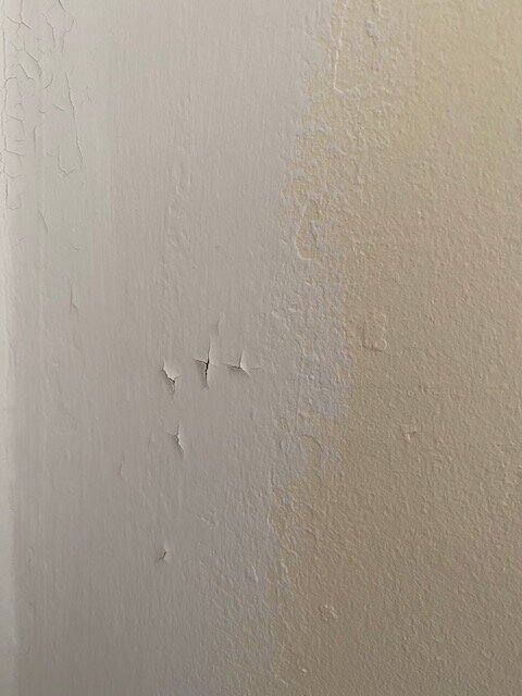

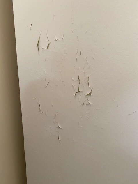

I've just started to decorate my mum's bungalow for her and noticed that after painting the walls, it's just not sticking and peels when dry.
It seems that it peels right down to the paint below that I was painting over.
I sugar soaped the wall and lightly sanded the wall but this has made no difference.
Not sure if it's the paint I'm using (Valspar) or if it's reacting with something.
I've attached some pictures to give an idea of what's happening.
Does anyone have any ideas on how to solve this?

The property is around 1960's and a local authority property so it's been painted a number of times before she moved in so would assume it's been done on a budget with whatever paint was available.
I made sure I let the sugar soap dry and wiped it over as well as sanding it lightly.
The bit that puzzles me is that it's taking the previous coat off that I was trying to paint over as well so can only assume that coat hadn't bonded particularly well either.
I didn't PVA the wall as assumed I wouldn't need to due to painting over a previous coat.
So you are saying the previous coat is coming off too.
What is behind that? More old paint, or bare plaster?
yes it appears the previous coat is pulling away as well leaving what looks like an old 1970's looking green coat. Also noticed the wall started to "yellow" a bit when I sanded it so wondered if it was reacting to an old paint? Wondering of old paints were oil based or something along those lines?
It's possible the green paint is distemper, which could often be in some horrible colours. Emulsion cannot be successfully applied to distemper.
Distemper can be removed with warm water.

Is the yellow old paint or nicotine?
please don't put glue on any surface you hope one day to paint.
do you think there is glue under the paint?
That lifting might be glue or wallpaper paste or kitchen grime, if the wall was not scrubbed clean and rubbed dry.
Thanks for all the replies so far. The part that puzzles me is why it's taking the previous coat away as well. Guessing that is where the problem started but the previous person to paint it some how managed to get it to stick.
Any recommendations on how to solve the issue?
