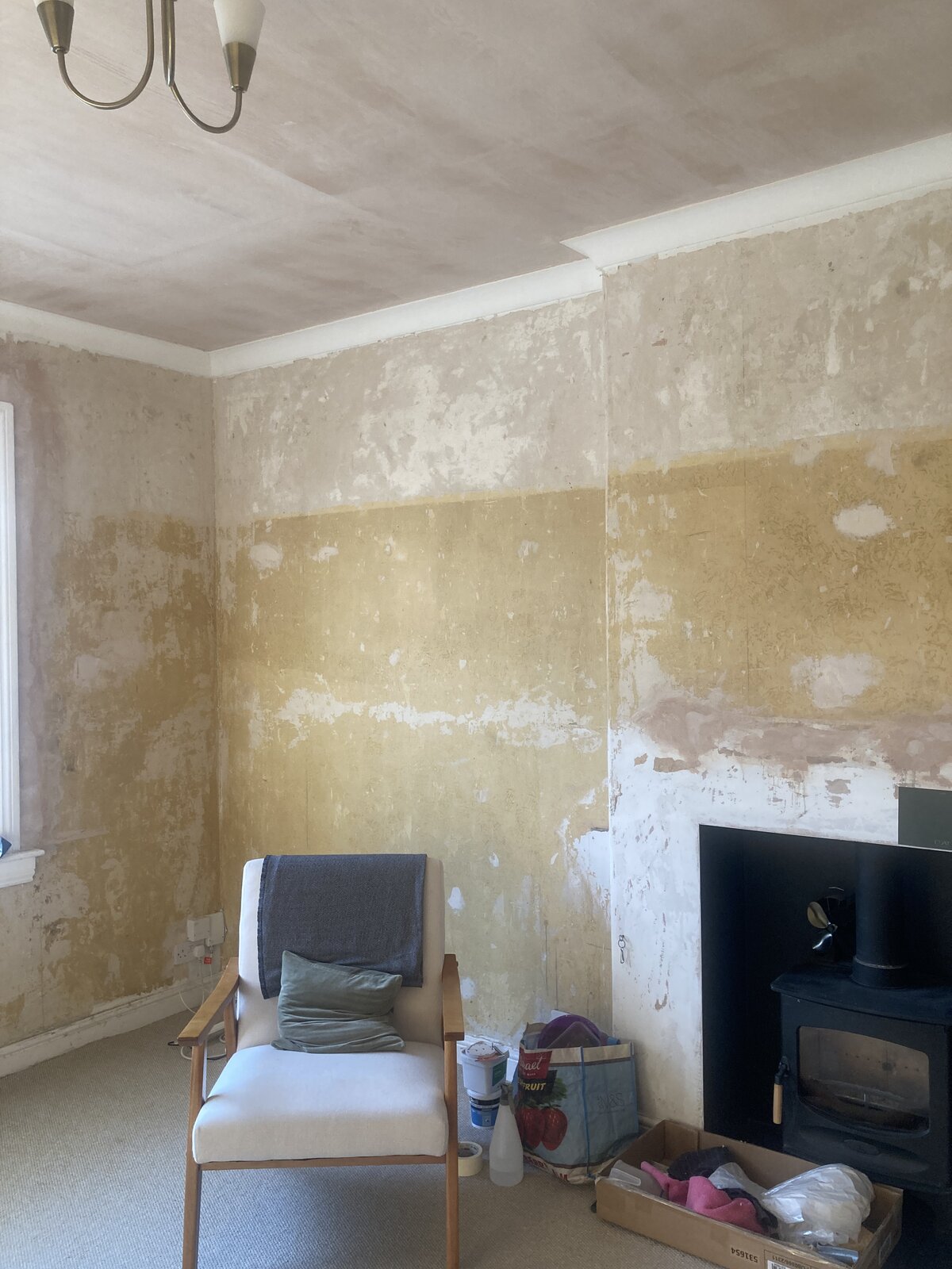

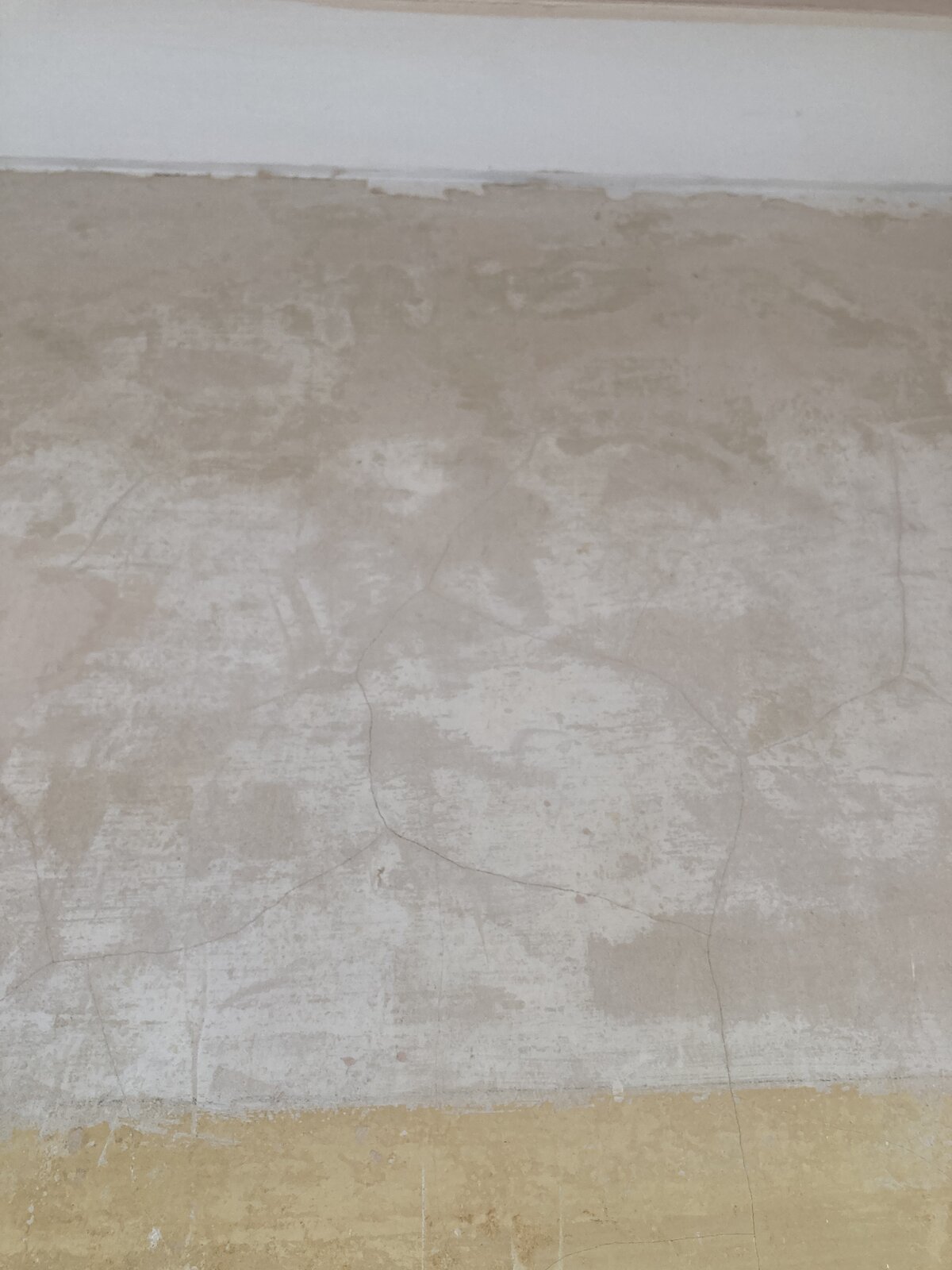

We have fully stripped the old lining paper from 2 rooms in our house. The paper was laid quite poorly and came away easily, however it revealed old lime plaster which has quite a few hairline cracks. I have bought a lime based filler to smooth over the cracks and we intend to just paint this room. Do i need to use a breathable paint like clay paint or graphenstone/earthborn or is a water based low VOC paint ok (Coat paint)?
Are water based paints in any way breathable for old walls?
We had to have the old lathe ceiling pulled down and replaced - this is now gypsum plaster on the ceiling, so the room is a bit of a mix of plasters now.

When I started our renovation of mostly lime plastered 1920 build, I was somewhat obsessed with using breathable paint.
Keim on the ceilings (i didn't check at the time but turns out they have all been over boarded n skimmed) , earthborn on the walls (after sanding back previous paint layers).
Given in the previous 30-40 years it appears owners haven't paid much attention to type of paint used, with seemingly little negative effect I'm somewhat less precious now.
Bought a load of lime plaster filler but ended up giving it away as I never used it.
Earthborn has a lovely matt finish, but reality is, its far from durable.
Heads up on lime plaster repairs for bigger areas if needed/where blown. Thistle One Coat plaster does a rather grand job / can be used in a similar fashion to the original.
Big fan of the Toupret "interior filler" product for filling in hairline cracks (bagged, mix it yourself)
Naturally, your mileage may vary, and the heritage types will call it bad cowboy advice, but I've had absolutely zero issues in 4 years ontop of lime.
