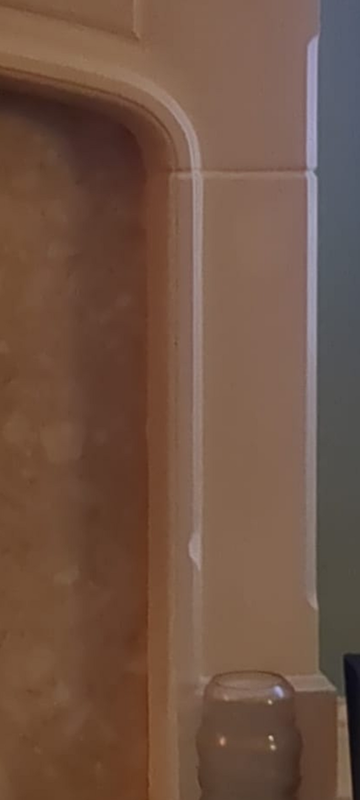

I would like to paint the plaster fireplace surround and mantle to the same colour as the room. Can I just paint straight over the old colour or do I need to prime.
There is also a bit chipped off (in picture) - is yher any way to fix this?
Thank you

Is the fireplace painted?
Do you know what sort of paint?
Rub with meths. If it comes off a bit on rag it's waterbased paint.
If not it's oil based paint.
Prep will depend on what sort of paint you have
