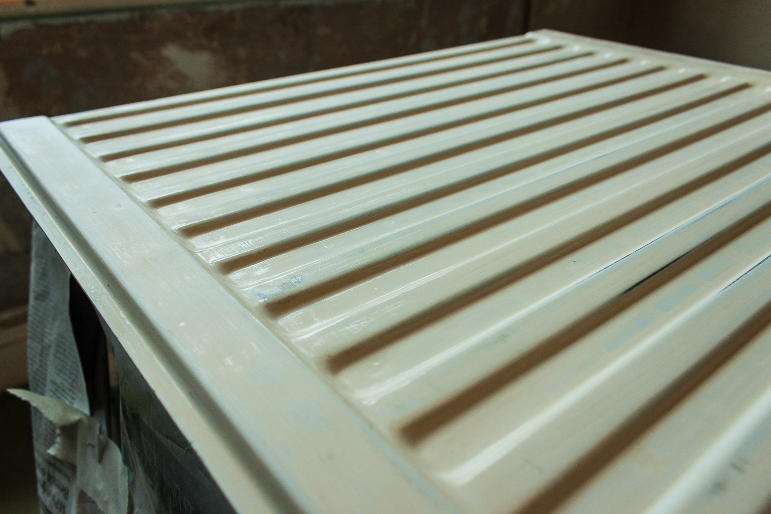

First I sanded the existing paint as that had been brushed on, had lots of lines, spots of rust and blobs here and there.

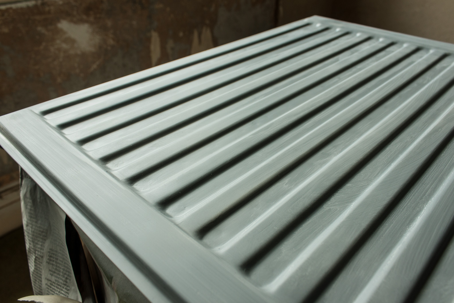

I then sprayed two quick coats of gray primer and gave them a light sand.

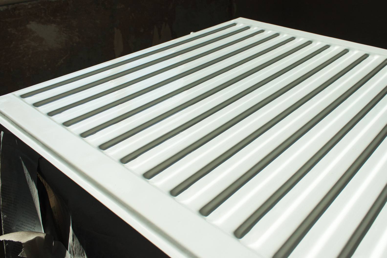

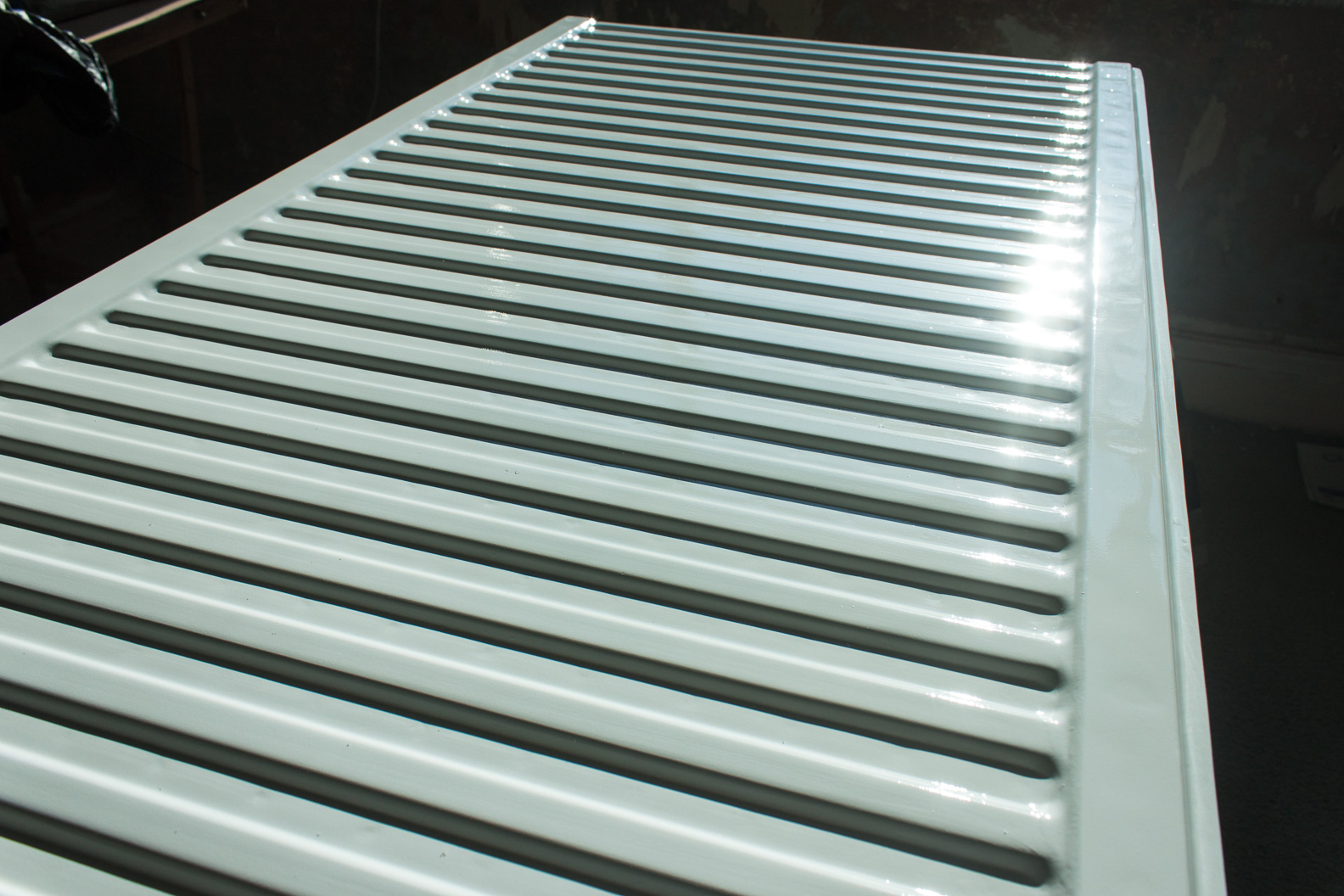

Then the gloss top coat. I gave it three/four think coats within 15min of each other as per guide on the can.

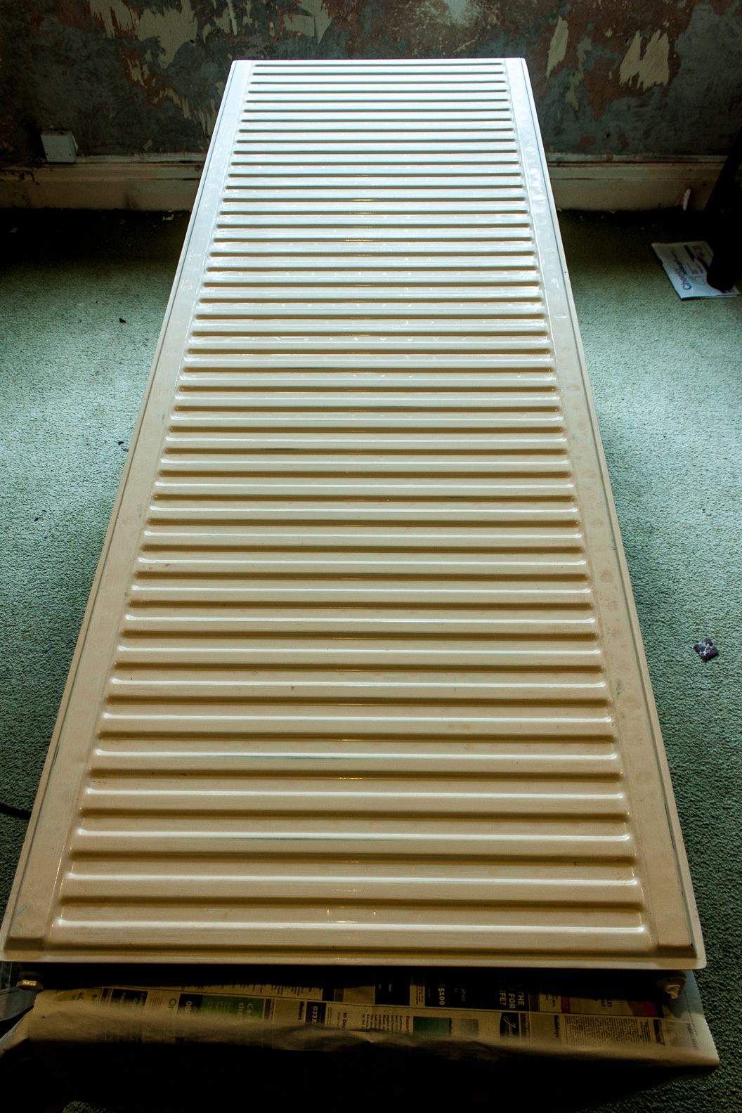

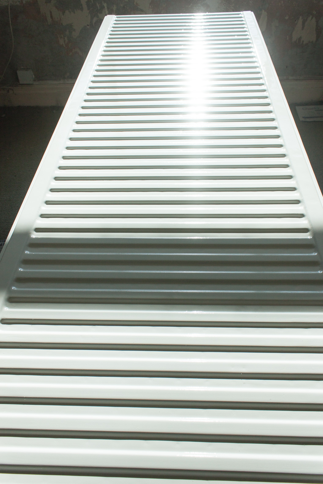

Now, at a quick glance, I think I did a pretty good job. There are minor surface imperfections, but that is to be expected with something with previous layers and the age these radiators are.
My question. Due to me attempting this for the first time, my consistency of spraying was a bit off. I can certainly see it is a bit too thin on one side.
If I leave this for a few days to cure and harden. If I want to do another coat. I assume it is best to give this coat a light sand before applying another one?
Or would it be fine to go straight on with another coat?
Is there anything I can do to minimise the risk of the dreaded spray paint wrinkle?
Many Thanks in advance.
Feel free to judge my first attempt! Or maybe suggestions to improve it.

I had a bit of an issue early on with getting the timing of the coats right on the other side.
From what I have learned since.....I waited too long for an immediate second coat, but not long enough for it to fully cure, so it reacted with the previous coat in one spot and I got the dreaded spray wrinkle in one spot.
So as this is the much larger side was was cautious about doing another coat. But it has had enough time to cure properly now, so a light sand, clean and another coat seems to be in order.
The good thing about using a gray primer is that it does help to see where you are a bit too thin.
