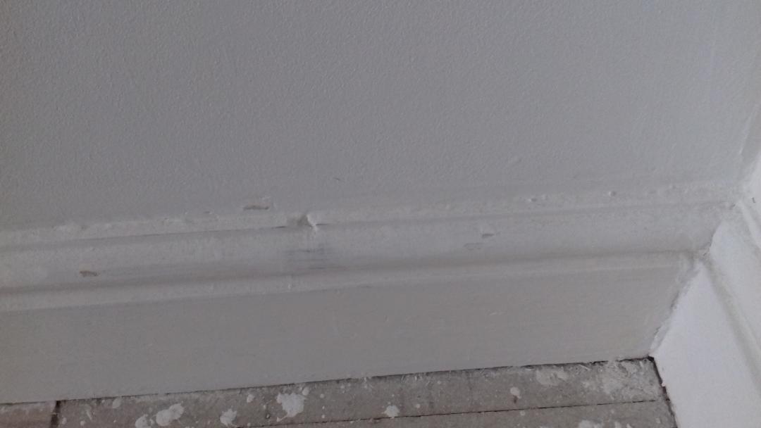

  3. Holes and bumps and bits in skirting: what is the best filler for small holes? Should i use powdered filler such as Toupret or a ronseal 2 part filler?

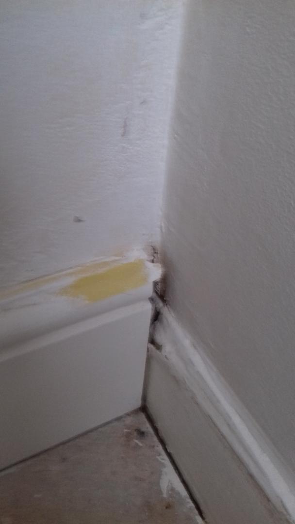

  4. There is a biggish gap in the corner where 2 skirting meet – it’s a mess – any ideas on how to fill this? (would ronseal2 part wood filler work?
I shall try to add some pictures

any 2 pack wood filler should do, that corner is a bit of a hatchet job, I'd be more inclined to cut the skirt off about a foot and insert a new piece if you can find a match to it and take off that small skirting and fit matching skirting but if that’s not viable you'll likely have to fill in layers to get a good fill. I would fill the bottom to the V first and shape that, if you time it right you can do a lot of the shaping before sanding. after the lower part is done you can then work on the curved bit. less is more with this and patience is the game. The little notch can be filled but just drill down into the wood a bit, maybe 5 -10mm to help hold the filler in place.
I second the 2 pack (car filler) recommendation for any knocks and bumps.
Please DO NOT use the powdered fillers that you add water too. After a few years they will blow.
Personally, I would be inclined to remove the remaining (less tall) original shirting and find some more torus skirting
