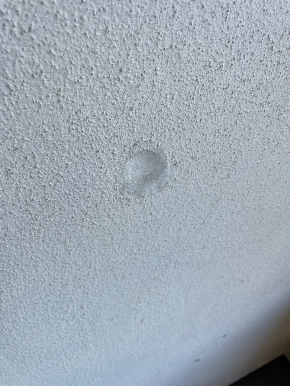

1 - what’s the best way to patch this up (left over from cavity wall insulation) so it matches?

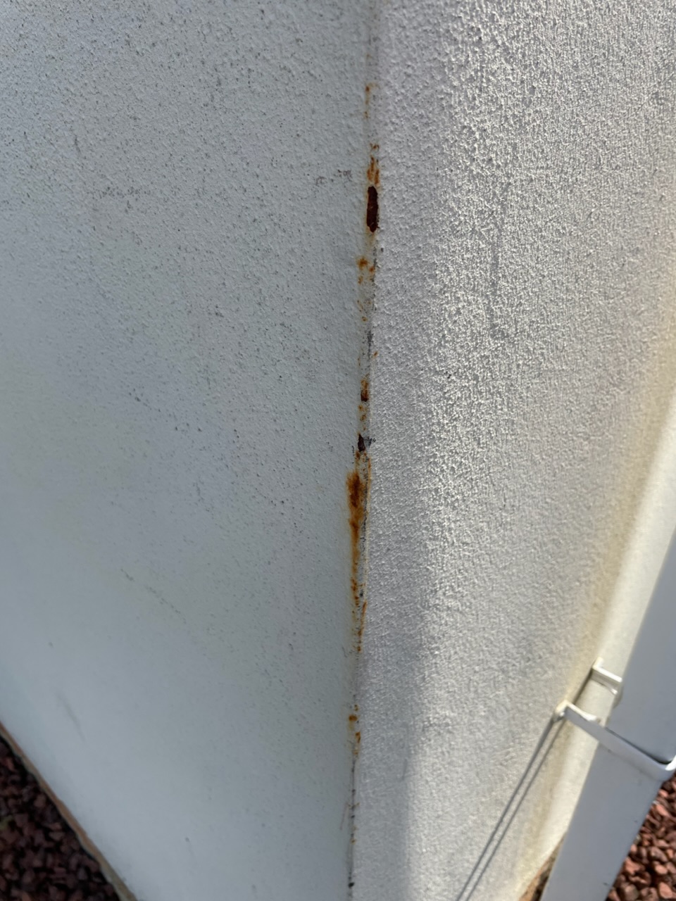

2 - how should I treat the rust showing through at the corner profiles before painting?

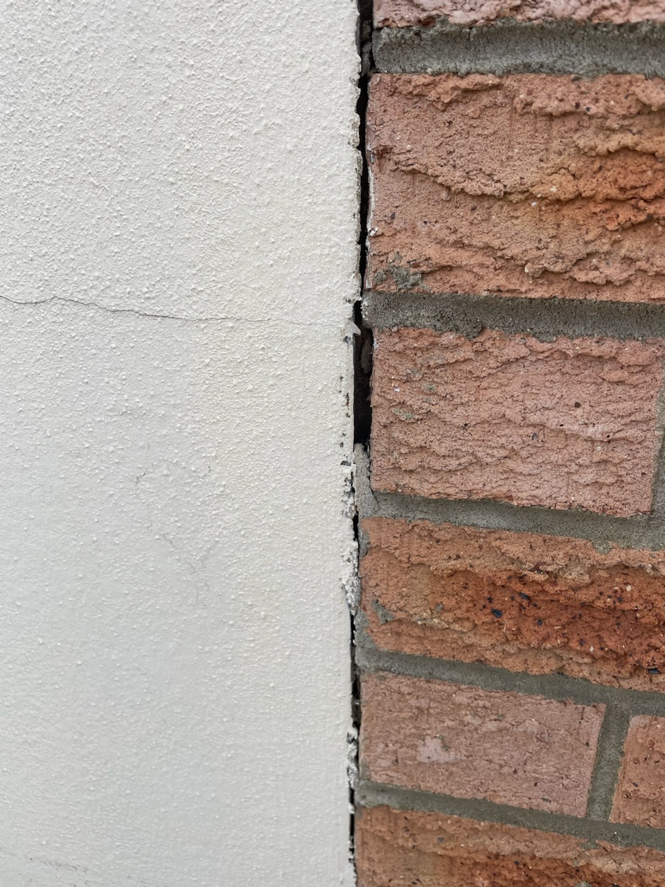

3 - what would be best to fill this gap between render and the brickwork?

1. Use a soft filler, once sanded, throw some paint in a small tub of the paint and stipple the finish with a brush.
2. The galvanised finish on the angle bead has failed. You need to prime the edge of the bead. I would use Owatrol oil but you probably don't have any. There are numerous primers/paints that can be applied direct to rust
3. I would use expanding foam, using a gun with a 2mm cone head, something like clear MS Polymer will be fine though
Again, after applying the first coat of paint, use sand to create texture.
4. Yeah, you didn't ask, but enlarge the crack to the left. Then gun in some Toupret Flex and Fill
It is caulk with tiny fibres. Blow away the dust from the crack. Wipe away any excess after you gun it in. Let it shrink back and then do the soft filler and sand in paint
The soft filler that I would recommend is toupret touprelith f filler.

For 3. - do I just fill with the OB1, smooth and paint over it?

Yeah. MS polymers are almost as flexible as silicone but they can be painted over. I would recommend a white version but if you are heavy handed, you may end up with the white on the brick face
MS polymers tend to need to be painted with waterbased paints first, they can then be painted with oil based paints (not relevant in this case though).
