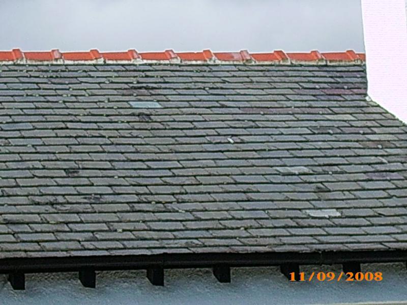

Weathershield Exterior Excellent. Used 2 coats exterior undercoat, 1 or (preferably) 2 coats exterior gloss on wood. Thinned down first coat gloss on plastic gutter, less thinned down second coat. 9 years later, as photo shows, there's no sign of flaking - very sunny aspect. Well worth the extra money and effort.
