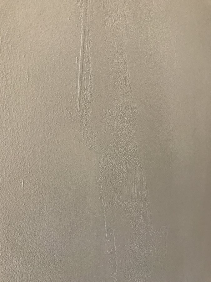

I am decorating my hallway and I thought I would test the colour I want by painting one wall (and an area on another)... it's dulux endurance timeless so just off white, I thought if I don't like it it won't take much to cover over... well the coverage was awful and it has a slight sheen to it, although it is Matt.
Today I have attempted to paint over the area with my trusty leyland white Matt emulsion and start again, however it doesn't seem to stick on the endurance paint, and has an awful transition to the original mist coated area.
I assume it's due to the endurance paint repelling it.
Any idea whether more coats will eventually work or do I need to sand back to plaster?
The awful transition I am referring to is in the picture attached. Left side is endurance paint over painted with Matt emulsion, right side is just Matt emulsion
Sand back, not right to plaster, fill with fine surface - maybe easifill if it's a large area then coat with zinsser gardz
Cheers Nige, should I just sand the high spots back or the area with endurance too?
I'm assuming I only need the filler if I need to level it out?
I have some zinseer BIN would that work? And what area am i applying this to... just the endurance area or the whole wall?

I haven't used Endurance but I have used Diamond matt quite a few times.
AFAIK, endurance is retail version, diamond matt the trade version.
In my experience, when applying over standard emulsion you have to be careful not to over roll, otherwise, yes you will end up with orange peel. The paint "soaks" in a lot on walls with higher suction (ie existing matt emulsion). Subsequent coats however flow nicely.
The finish is less matt than standard Dulux matt but it is no where near as shiny as vinyl silk.
I can't see any problem with thinning the first coat if it helps (alternatively add some floetrol).
For what it is worth, I am currently using Farrow and Ball's version (Modern Emulsion), which is really crap. A week after having painted the skirting, the F&B is fisheyeing when I cut in. I have to leave the lid off the tin over night to try to make the paint thicker.
I have no issues real issues with Endurance in itself, I just tried to use it on a wall that was too bad patchy to start with.
The issue I have here is the transition between an area of endurance and standard Matt emulsion.... I've tried sanding level and re-painting but it's still awful.
Might use a roller with a thicker nap to build up the paint, and hope it starts sticking to the endurance

fisheyes are "dots" where the paint has pulled back from the surface,
Imagine taking a cotton bud and removing pin hole or larger sizes of paint from the surface.
see the images in the fisheye section of the following page.
http://www.neopaints.com/product_troubleshooter/tr04-timber-substrates.htm
The emulsion looks fine initially but minutes later your straight cutting in line becomes broken and pitted with pronounced ridges.
