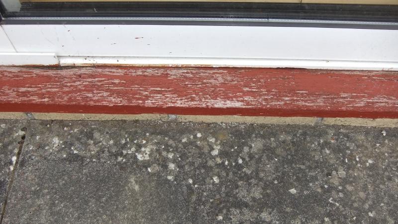

Painted my outdoor patio step a year ago with wooden fence paint. This is the result.
Can someone tell a better paint to use that won't be in this state one year from now?
Rub back and give it three coats of exterior woodstain, may need a top up every years or so as horizontal surfaces don't last as long as verticals.
