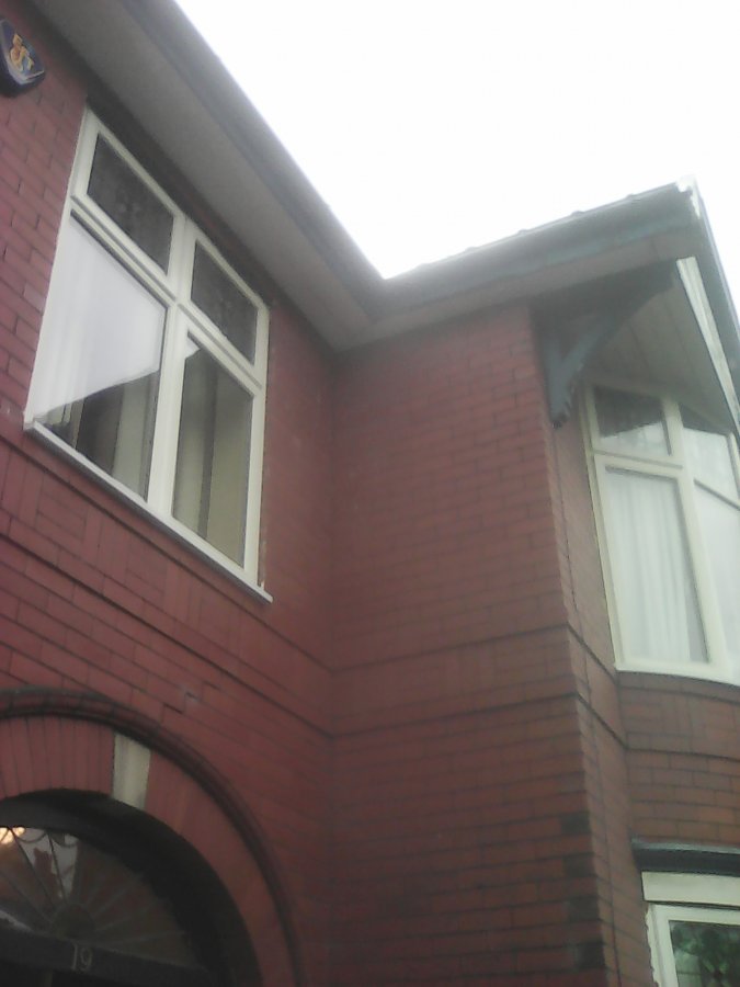

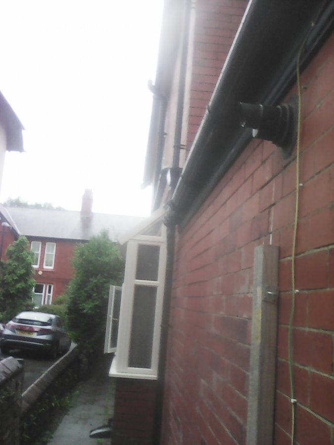

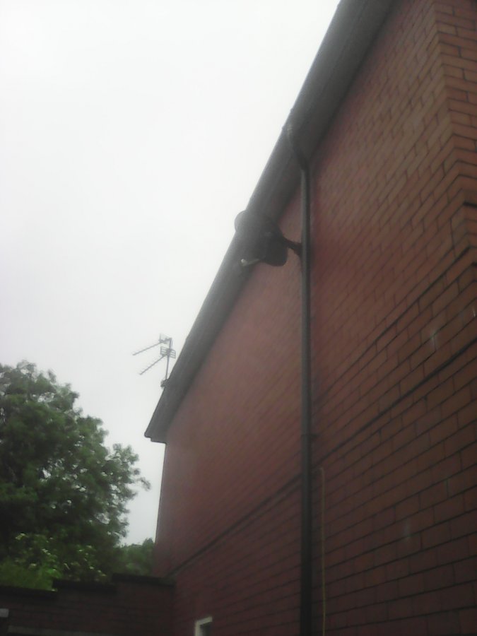

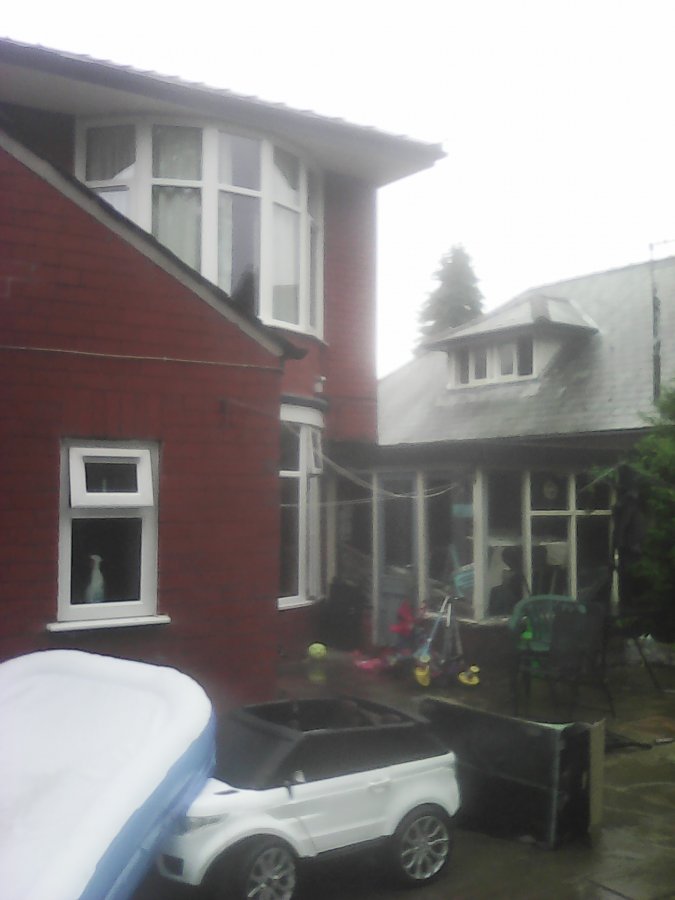

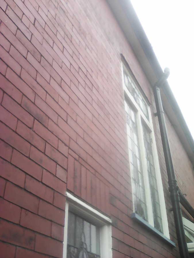

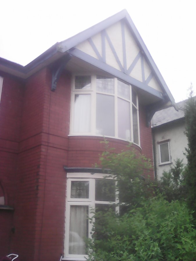

I started painting and decorating after doing some training and recently someone asked me about painting exterior fascia boards, soffits and upstairs exterior side of the windows etc.
I'm not sure what to charge here in the northwest and also what access equipment I can get to do it? The front of the house height is about 6.5m, width of house about 8m, length of house about 14m

I have found in the past that Scaffolding firms will allow extra time for their equipment due to delays for unforeseen circumstances and bad weather, its in their interest as you are more likely to go back to them at a later date, but its something that you should make your customer aware of when you quote for the job.
Due to different styles of property you could end up wanting a large range of Access equipment, much of which may not be appropriate and will not conform to Insurance Inspections/ regulations if it fails
At least a Scaffolding Firm will have its equipment insured ( possibly !!!!)
Rule of thumb any work above First Floor level (Gutter Level) requires scaffolding/Platform or any works above ground floor level on a public footpath/highway requires the same, covered by Public Liability Insurance .

For the benefit of the OP, I do mainly site work (admittedly as a joiner) and I'm expected in addition to a CSCS trade (competence) card, to hold appropriate Public Liability Insurance, have undertaken asbestos awarness training (because some older soffits and fascias can contain asbestos), a PASMA scaffolding tower card (assembly and usage training) as well as having a Working at Height certificate (in order to use a harness like the guy above safely). All the decos I've worked with in recent years have this sort of stuff and often additionally hold training cards for IPAF (e.g. scissor lifts, cherry pickers, etc). Insurers are becoming wary of covering you if you haven't had the appropriate safety training on this sort of thing as untrained users of access equipment can get into all sorts of bother. Because the range of equipment is now so great it may be better, as others have said, to hire in equipment as required. Most hire companies will advise on an appropriate set-up and many can carry out certificated training. As an independent you don't necessarily need all this, but I'd say that some form of ladder training, PASMA scaffold tower training and the asbestos awareness would be the minimum required. Remember that ladders are a contributing factor in a very high percentage of accidents at work and that's why professional outfits often opt for a scaffolding tower or even a MEWP (mobile elevating work platform, e.g. cherry picker, etc) as a safer method of access especially when working above ground floor level
BTW, that photo may look OK, but if you ever do use a harness you absolutely must work with a second man who is briefed in how to get you down and out of the harness before you injure yourself - 20 minutes hanging around in a harness can cause a build up of toxins in the legs and you can die of toxemia when they do get you down after such a long period.
