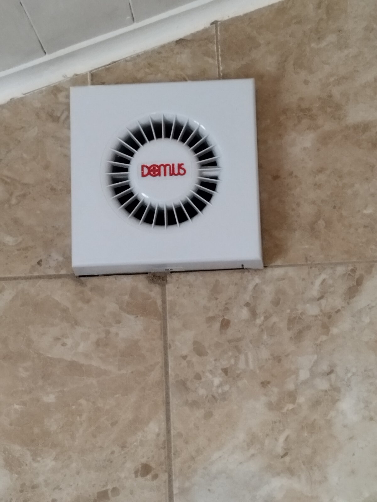

As it is still damp I surmise the extractor is not up to the job. It will work better if the door and window are CLOSED and you run it until the room is dry. Is it a 100mm fan in a wall duct? Can you post a pic?

100mm fan

Looks like a typical cheap builders fan, will be rated about 80 cu.m/hr. Adequate for a WC or washroom, will struggle with a bath, inadequate for a shower.
You can buy a slightly better one, but a significant improvement would need to be bigger, and you are limited by the size of the hole.
Can you leave it running permanently? Does it seem to work? Is it noisy?

Lot of things have been done cheap and nasty we've found. It is quite noisy i must admit.
It has a separate switch on wall outside bathroom, would it be possible to install a more powerful one with a timer using same wiring?
It probably does not have the wiring to run a timer. But you could change it for a Silent 100 that you could leave running continuously.
This is quite a good price but you might find it better.

I use these, and they are so quiet I can't hear them outside the bathroom or WC when the door is closed. This is very handy in an en-suite where you don't want to disturb someone.
They are also sold under the "Soler & Palau" brand name, which is the parent company of Envirovent. The prices are sometimes different. I am very happy with the quality. They also make more powerful ones but they are too big for your position, usually fitted in the loft above the bathroom ceiling. Example on https://www.diynot.com/diy/threads/replacement-bathroom-extractor-fan.606840/#post-5422494

Another way is looking at installing an inline extractor fan, I know you have a fan installed but if you have space above in the void/loft these are three times the power of a wall mounted bathroom axial fan. As they are installed outside the room they are just as quiet too.
This will extract a lot of air at a similar energy usage rate of a bathroom fan.
I agree.
If you have access in the loft above, it could be much better. You would have to install a duct from the bathroom and out through the wall.
