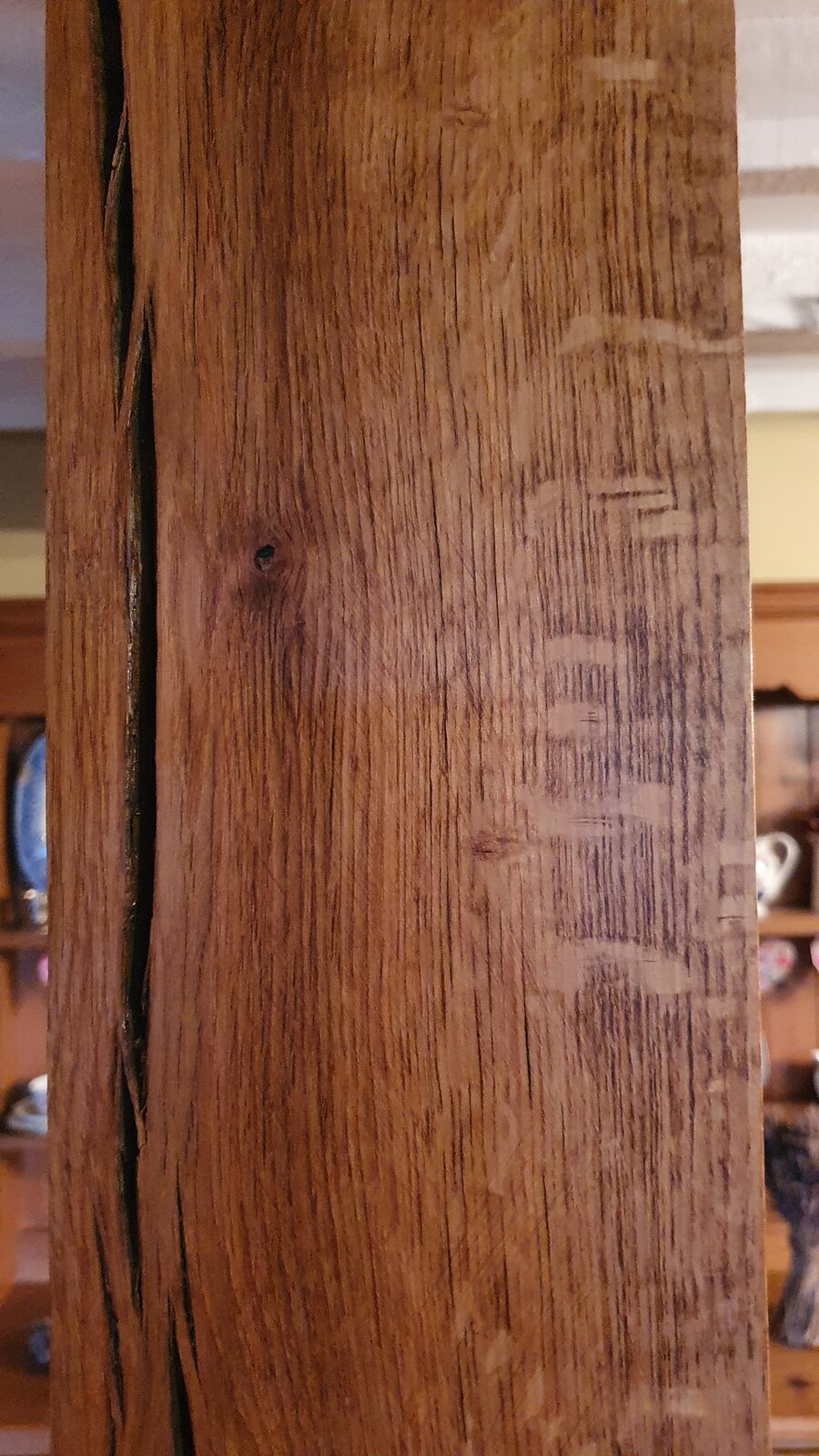

Here is a piece of oak I recently coated in pure tung oil (well, quick drying, so actually not pure, but no yellowing linseed in it). It's beautiful. And also French Oak. But it had been air dried and open to the elements. I love it.
