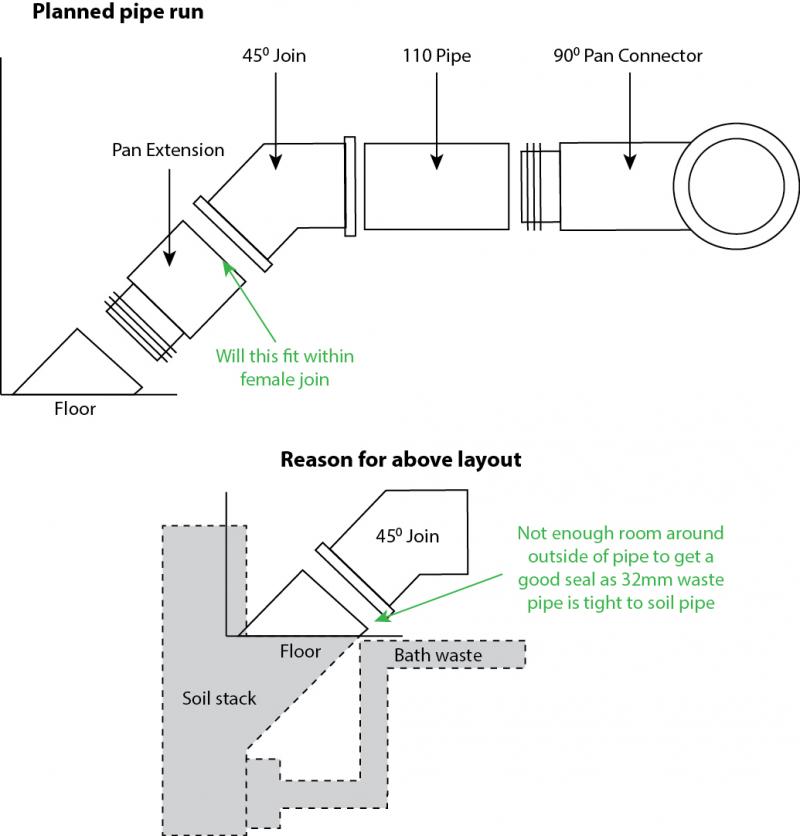

There is a 110 pipe coming out of the wall. As there is not enough coming out to get a female joint over it I was thinking of using the fin end of the extension to insert. Then attach a female bend to the large end of the extension which looks like the size of 110 pipe. Then I would insert a small run of 110 pipe and connect a 90o pan connector to the end and fix to the toilet.
Just wanted to know if the extension is 110 at the larger end so that it would fit in a female join. How that makes sense.
Sorry but I don't quite understand what it is you are doing.
Are you moving the toilet further along the wall?
