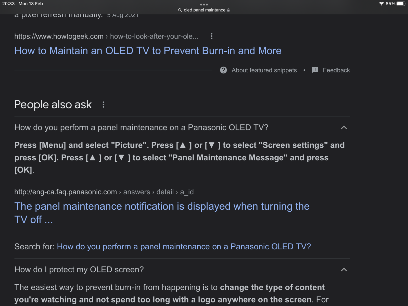

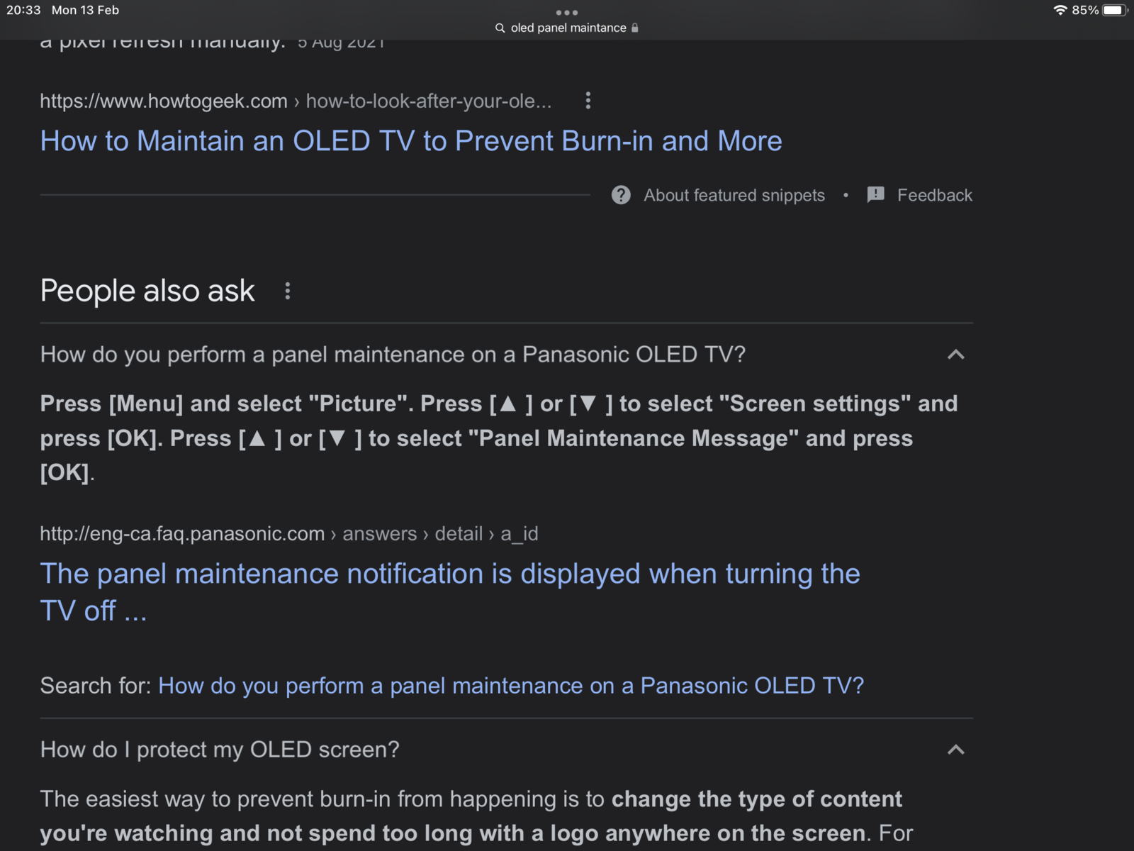

Think it’s asking for a refresh …
Tried all the suggestions still no joy, am back up at daughters house tomorrow so will try again and unplug all connections, fire stick, Bluray, Nintendo and Ethernet cable.
