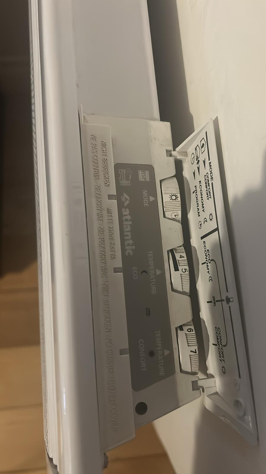

I have two of these flat panel electric radiators for which the controls don't seem to be working properly and I have lost the manual. The radiators work at times but I am not able to set them to work continuously (even with thermostat dials at max). Does anyone know how to adjust these or use controls properly or should I just swap them out for newer ones. Thanks

Do you have an economy tariff that only supplies the heaters at night
The basic idea of the storage radiator is to heat up with off-peak electric, and to then release the energy when required, other than the central cupboards with circulating fans, which could stay hot for a week, the after build version were never really a success. It would not retain the energy well enough, so would often get cold before the off-peak was available to recharge them.
The tariff was called Economy 7, and there were a host of ways to use it, from the original white meter, to the modern smart meter, and sometimes the heater turned the supply on/off with a sensing signal, and sometimes the electric meter turns it on/off. There was an Economy 10 where one got a midday boost, but today we have a whole host of names for off-peak power, aimed at EV chargers (often 5 hours but sometimes 7 hours) and solar panel users with storage batteries (can be as low as 3 hours) and some three stage, off-peak, standard and peak, the latter often 4 pm to 7 pm.

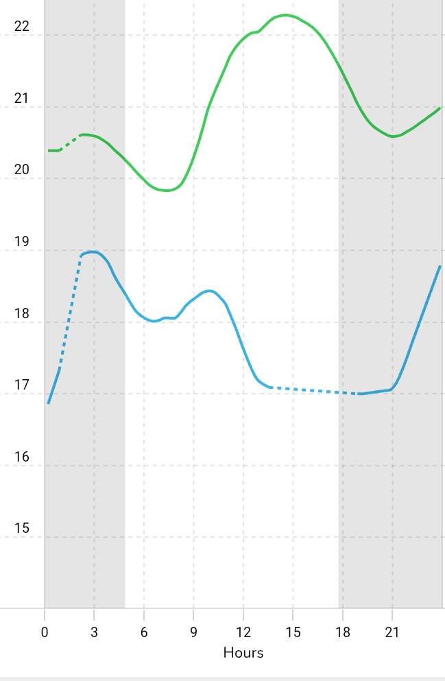

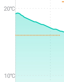

I can see with my house how fast it cools, 1743531221743.png I can see midnight until 7 am room cools 3ºC 1743531509116.png and I can see what other rooms do, how fast they heat and cool when the heating turns on and off. But most people have little idea of heating and cooling speeds, so to work out how much needs to be stored, is near impossible, we have considered a storage radiator, or at least an oil filled radiator, as often around 1 to 3 pm we are giving away electric. Autumn and Spring, yes it would likely work well. But Winter not enough solar, running a heat pump to cool the home great, but to heat it, so much depends on how well insulated.
