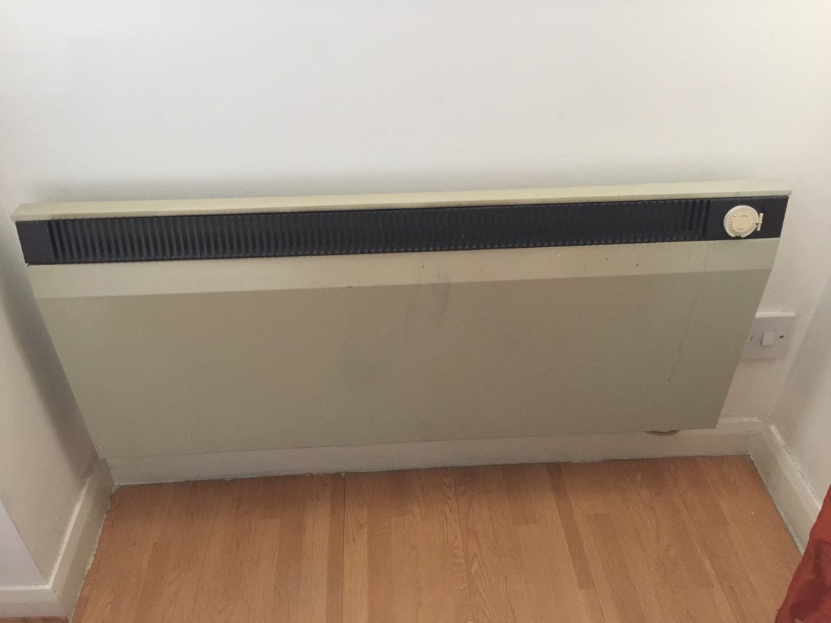

These are the radiators we are reoplacing. can anyone tell me the likely wattage of these?
You can't tell just like that. They probably have a rating plate on the back which will tell you. Failing that you could measure the resistance with a multimeter and calculate it. Watts equals 240 x 240 divided by resistance.
