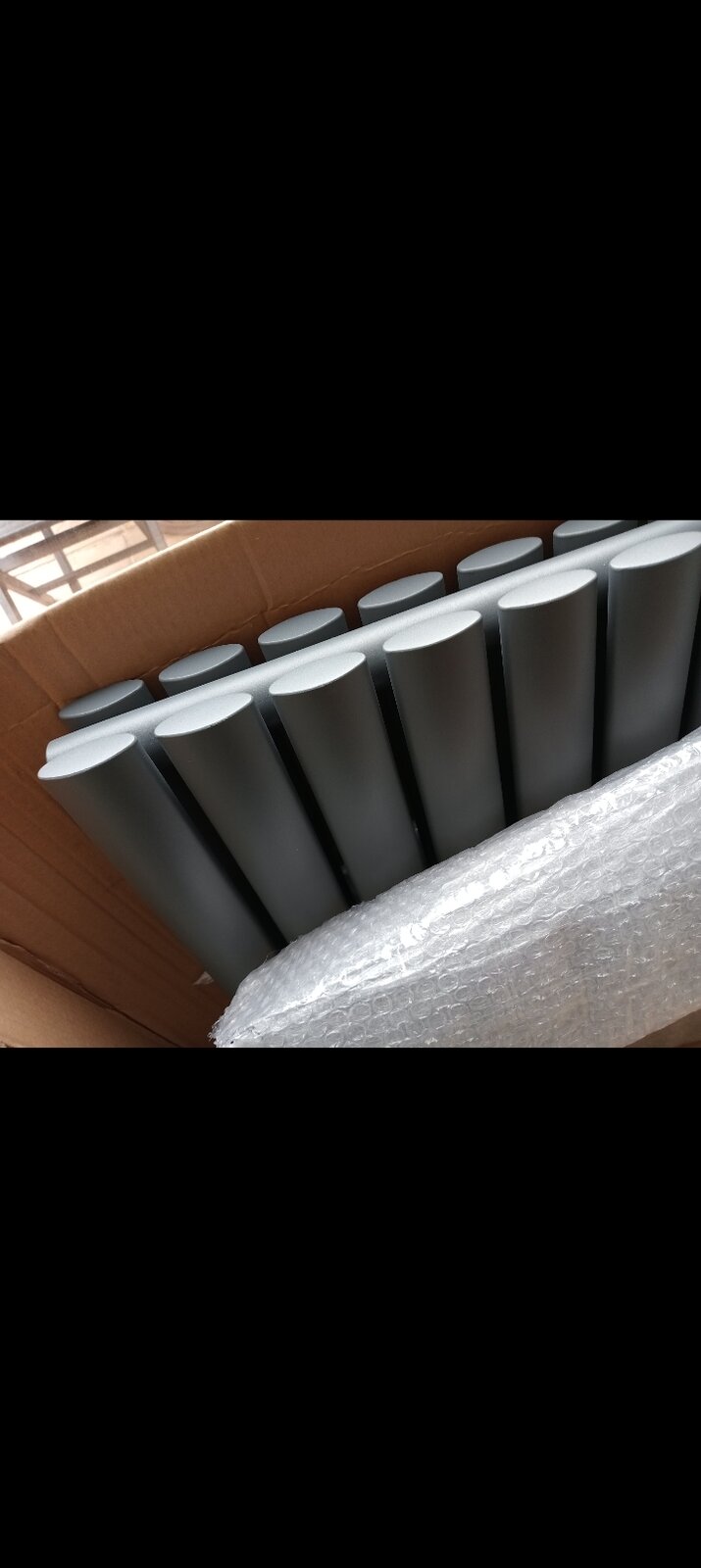

Do this radiator have a top and bottom or can you just screw your tails in which end you want and bleed and blank screw the other. There doesn't appear to anything to suggest there is a top and bottom. But it's the first time I have fit. Thanks

If there is no baffle inside any of the radiators 4 ports,and it's symmetrical in shape ,then it's irrelevant which way you fit it .
Thanks there doesn't appear to be any baffles. No instructions came with the radiators. So I'm presuming there isn't.
