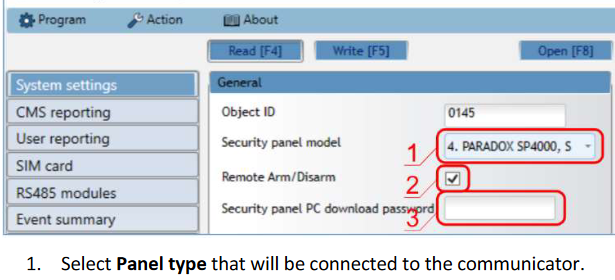

Do I leave the objectID as the default? Then create my own panel pc download password here.

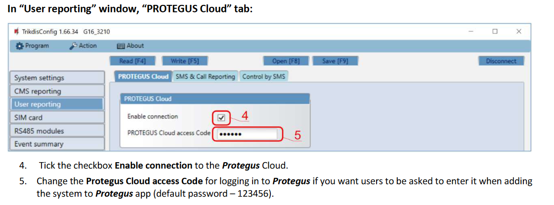

Add a new password for the protegus cloud:

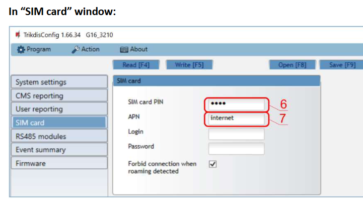

sim apn setting, pin and apn

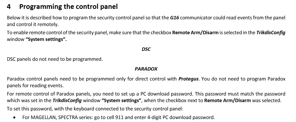

Then the panel codes - 0000 - 911- pc download passcode I set before
