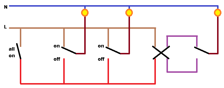

So a strange request I have had to help someone out.
Basically they want to be able to switch all the lights on in a building at once, regardless of the position of the wall switches. They want to also turn them all off (or at least return to the previous state when they turn the central control off.
To me it seems the only way to do this would be parallel switching, basically take 2 lives from the same MCB, run one live through the wall switch to the light fitting and take the other live feed it via relay to the light fitting. So you would have 2 live wires at the fitting.
I have tried to find reference to parallel switching in the regs and can't! Part of me says you can't do it, but part of me is struggling to find a reason not to if you put a 3 pole isolator beside each light fitting to isolate it for servicing purposes. My background is electronic engineering and in the past I did used to specify some electrical systems within my job, but it's long before the latest regs.
It's essentially going to be like the systems you see if movies for switching all the lights on in a fire station, when the callout alarm sounds.
Any thoughts? Or at least where in the regs it states you cannot parallel switch the live?
Each switch has a normally open relay contact connected across it, if ten switches then ten sets of relay contacts.
The relay contact sets can all be on one multipole relay or distributed over a number of relays. It will depends on the existing wiring layout which will be the most cost effective design,
The central control switch supplies power to all the relay coils to energise them and thus close the normally open contact sets.,
Bear in mind that turning on a lot of lights at the same instant will create a large inrush current that may be enough to trip the MCB for the lighting circuit. Using multiple relays would allow the switch on to be sequential and reduce the single inrush current to be several much lower inrush currents thus reducing the risk of the MCB tripping

Depending on the size of the installation relays are not required and the way it's currently wired, it can be done with 2 way switches [or an intermediate for 2 way]:
'Overide' wiring shown red and 2 way 'Strappers' shown purple.
However Bernards comment about inrush needs to be considered if it's a large prperty.
This takes me back to a large commercial property with a really horrible and frequently modified version of this for occupied/unoccupied use.
Thanks everyone for your comments, my initial thought was doing something with 2 way switches but couldn't work out what!
MCB inrush current shouldn't be too much of an issue as all the lights are LED, and there is only 4 or 5 rooms.
Thanks SUNRAY for the diagram, I won't need the additional 2 way stappers.
The inrush current to some LED drivers can be high as the 230 Volt mains is rectified to DC to charge a capacitor with minimal is any effective current limiting in the design.

Before Ethernet the simple system in SunRay's post was used in Fire Stations, simple effective and reliable in operation. Probably still is used.
