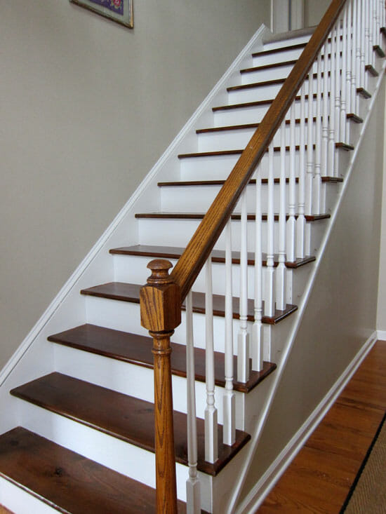

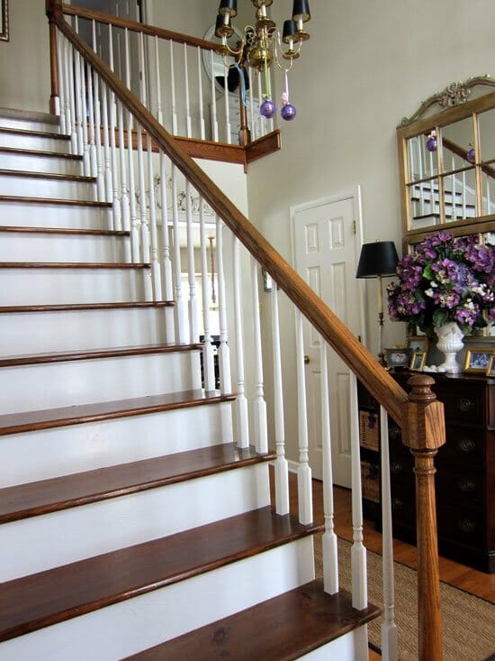

The idea of cladding might be OTT? If I can get my treads to clean up and take stain?
