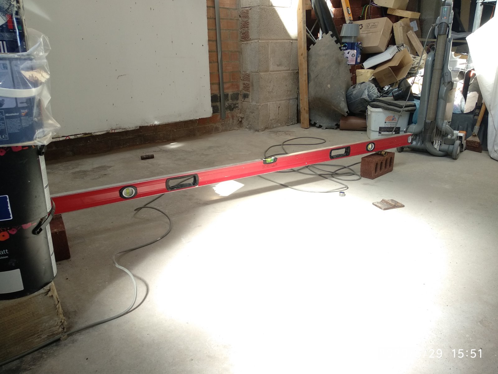

Hello, a bit of thread resurrection but we're finally in a position to start on the utility room conversion and had a few questions/ things to confirm.
The current concrete floor with DPM is 115 to 127mm lower than our intended finish height. With the variations in level we were thinking of self levelling the floor to bring it to the 100mm ish region.
Are we right in thinking that the floor needs to be first prepped in a mapei primer for concrete before using mapei ultraplan?
This would then be built up in:
  1. DPM
  2. 75mm PIR board
  3. 18mm T&G chipboard glued together
  4. 6mm Hardiebacker screwed to chip
  5. Tiled to finish on flexible adhesive
Would we need a "slip" layer between the PIR and the Chipboard or is this not necessary?
The single skin wall has two courses of blue engineerings that are two courses above current floor height (shown below). Would we have any issues with damp from the wall via this or from the blockwork pier? Would a liquid DPC be of benefit?

I don't know how it works with the regs and the insulation, may be some payoff between less on the floor and more on the walls or even a reasonable request to the BCO for such a small area but if I was doing that as a utility with a tiled floor I'd want 50mm celotex and a screed on top. I think layers of celotex, chipboard and cement board with tiles on top is a recipie for disaster - imagine a small leak from the back of the washing machine getting under those tiles and into the chipboard!
Thanks for the reply, just spoke to our BCO and explained that the room will be unheated and we will be going over the recommended amount with all the other insulation and his reply was no.
Because it might become a habitable room in the future it has to be done to regs.
Can anyone help with the other questions and room construction?
Yes the way it was explained to me is they are signing it off based on what they can see but someone else might buy the house and decide to make it into a baby nursery for example, so the ventilation and insulation etc all have to be correct. If you keep the insulated fire door from the main house and lower floor level you could call it part of the garage and leave it uninsulated, but once you lose any of those it's part of the house and needs to be done properly
