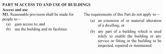

I believe Part M requires the breakers in an enclosure to be mounted between 1350 and 1450mm?

Height recommendations only apply to new-builds and complete refurbishments.
It's your house - but the DNO will only do what they want.

With regards to this "Height recommendations only apply to new-builds and complete refurbishments."
Even then, the height requirements are only recommendations.
This is all that Part M of The Building Regulations says:
Having said that, the height recommendations are actually quite acceptable when you get used to them.
They do not stop you having sockets and switches etc. wherever you want.
As I said, though, the DNO will not put the incoming supply anywhere they don't want to - nothing to do with Part M.
Even then, the height requirements are only recommendations. .... This is all that Part M of The Building Regulations says: ....
All true. However (personally having zero experience of this) I wonder whether (some/all/most) BCOs may take the view that if something does not 'comply' with the recommendations then it does not constitute the "reasonable provision" which is required by Part M?
In other words, I wonder how flexible BCOs are in relation to deciding what constitutes "reasonable provision"?

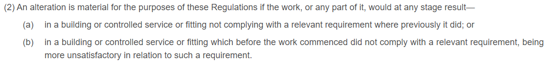

So what's the difference between 'complete refurbishment' and 'material alteration'?
Dunno. The definition of "Material Alteration" in the Building Regs refers to 3(2) (as below), but they do not appear to talk about 'complete refurbishment' ....
As far as I can make out, it is saying that work is only a 'material alteration' if it turns something compliant into something non-compliant, or if it turns something non-compliant into something "even more non-compliant" - neither of which would seem to be very likely scenarios!
It seems that all that matters to the Building Regs (at least, in the context we are discussing) is whether or not the work constitutes a "material alteration" (presumably per above definition) - and, as above, it would seem (at least, to me) unlikely that any work, let alone a 'complete refurbishment', would constitute a 'material alteration' by that definition. If that is true, then Part M would presumably almost never apply to anything other than a new build.

Did you notice that 'the requirements of this part do NOT apply to...a material alteration'.
For what it's worth I think 'new build' is the deciding factor.
Did you notice that 'the requirements of this part do NOT apply to...a material alteration'. For what it's worth I think 'new build' is the deciding factor.
Yes, of course I noticed it - that "NOT" is obviously the crucial basis of what I just wrote, namely ....
.... If that is true, then Part M would presumably almost never apply to anything other than a new build.
Kind Regards, John
it would seem... unlikely that any work... would constitute a 'material alteration' by that definition.
The Building Regs stated: 'the requirements of this part do not apply to...a material alteration'.
Therefore it would seem to follow that Part M does apply. (Which for the record I don't believe.)
