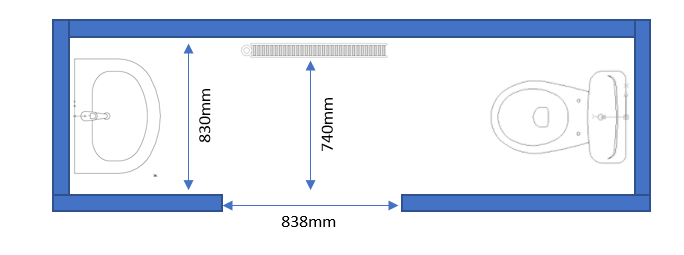

Folks,
Am I right in thinking that if I currently have a ground floor WC that isn't Part M compliant, then I am OK move the contents of the room around without needing to 'upgrade' it to be Part M compliant? Currently it is a very inefficient use of space, I want to move the toilet to the other side of the room and fit a smaller sink to allow some storage to be built where the toilet used to be.
Does alteration to an existing bathroom require Building Control signoff?
Cheers

Shouldn't be, it's going from this:
To This:
So I'm not changing the width of the access, or the size of the 'turning circle' in the WC (which I don't think is Part M compliant in any case due to the radiator).
You can do what you like. You have no obligation to comply with Part M. To quote the man:
The recommendations of this volume of this approved document apply to newly erected dwellings, and dwellings undergoing material alteration, only. They do not apply to the extension of a dwelling.
'material alteration' in this context amounts to "don't make it worse" - although in practice people often 'make it worse' without any fuss - for instance, removing an entrance level WC.
What I would suggest is putting the basin where the rad is - now't worse than sitting on 'bog burning your left knee;)
how big is that radiator? it only really needs a very small one if at all.
