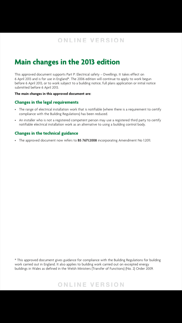

Part P only applies to England and excepted energy buildings in Wales.
AIUI part P applies in both England and Wales, but when it comes to the associated notification requirements (which everyone calls "part P" even though they perhaps shouldn't), wales is still on the "old" rules.

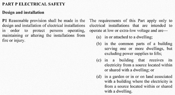

Sorry, I must have misinterpreted the wording in the document or it’s written somewhere else?

It looks like Wales now has it's own version of approved document P but it is substantially similar to the original English version. In particular, unlike the current english versions it still reffers to BS7671:2001 with amendments 1 and 2. It also still contains the reference to "an equivalent standard approved by a member of the EEA" which is no longer in the English version. Finally it still reffers to the "old" notification rules as the "new" notification rules were specific to England.
I would presume that Wales did not bother to change anything when they decided to stay the same in 2013, unlike England who almost (unfortunately) did away with all the notification rules.

The current (England) version of approved document P says.
Electrical installations should be designed and installed in accordance with BS 7671:2008 incorporating Amendment No 1:2011.
Seems pretty clear to me. It delegates the details to "how to follow the building regs (in an electrical sense)" to a specific version of BS7671.
