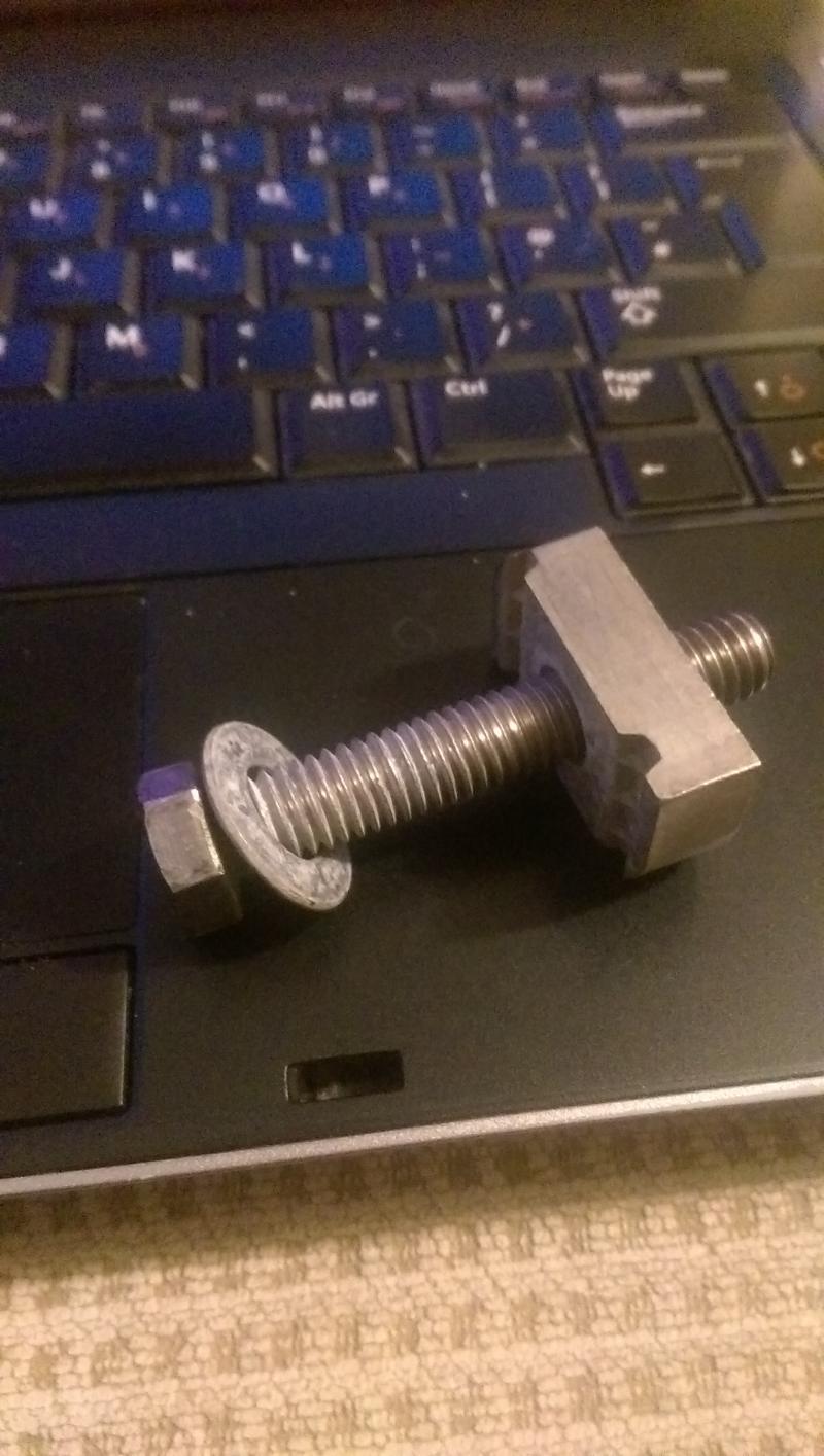

Hello everyone!
we have some solar panels for a piece of kit. Unfortunately the rail fasteners/bolts came off during transport and we need to purchase some more. The piece I am speaking of looks almost like S-Flex Solar PV Mounting S-Flex Hammerhead Bolt M8x25, but not quite. See the pictures, I really would like to get new fasteners rather than replace the rail!
To help the T area dimensions are 35mm length, 21mm width,10mm depth.
The bolt thread diameter is 10mm so I believe that makes it a m10 bolt?
thanks in advance!
M10 channel nuts. No great experience of them though. The ones I've used have always come with the channel or rail.
They also come with springs and known as zebedees.
Unistrut make the channel and accessories afaik.
