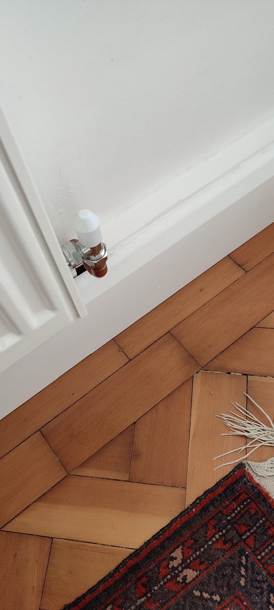

In both my house and my girlfriend's flat I have fitted lengths of 34x34mm (nominal) PAR or PSE above offending pipework or cabling, then fitted new skirting onto that. (Hers is a local authority rental, in which messing with piping or electrical trunking, of which there is quite a lot, is not allowed. I have no such constraints but have a long damp-proofing guarantee which would be invalidated by cutting into the re-plastered areas). Of course it's obvious, but I personally think it looks better with the flat top than unusually thick skirting with a rebate cut into the back. See pic. Yes, I know it needs re-caulking and tidying up.
And if anyone can tell me the practical difference between PAR and PSE, I'm all ears...
