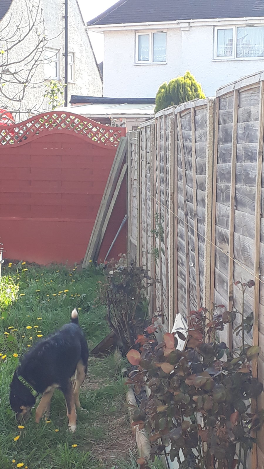

Hello,
So I've got a semi (lol) with a panel fence in the back garden along the boundary with my adjoining neighbour. I thought a previous owner (family member) had installed the concrete posts and fence panels around 30 years ago, neighbours says they installed. Neighbour has definitely replaced the panels around 10 years ago and paid for all works. Fence seems to sit astride the boundary.
Basically it's old now and looks shabby, was never stained, sound enough but starting to bow in places, capping at the tops of panels lifting off etc and I'd like to replace. Neighbour doesn't want this done even though I would do all the work and pay - reason given he just doesn't want it done...
Not a question about ownership or my rights to replace, I've accepted rightly or wrongly that my only option is to install new posts and panels on my side of this fence - so 2 fences right next to each other, will look odd but not much else I can do I guess.
So onto the real question - I have notified him under the Party Wall act with a template letter 6 from https://webarchive.nationalarchives...k/uploads/br/BR_partywall_explain_booklet.pdf and given the needed 30 days notice before works commence.
Only served the party wall notice as the fences will be so close together that any hole I dig for posts will go under the existing fence and I'll need to lift his panels to dig - and these 'foundations' will more than likely go under his flower beds by a couple of inches - I understand the party wall act gives me the right to do this?
So anyway, I can obviously have panels/posts/gravel boards delivered and get them stained before the 30 days - I'm guessing I can dig out holes on my side of the fence before the 30 days as long as I don't touch 'his' fence?
Tricky one as he's a right grumpy old man, being sensible and erring on the side of caution I should leave everything till the start date but then again want to get cracking ASAP - and after all it's my bloomin' garden I'm digging holes in before the start date!
Any thoughts please?

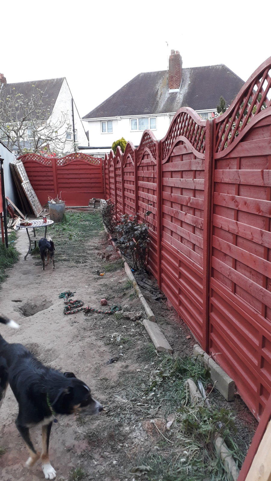

Common sense (or rather his wife bending his ear) won the day and used the existing fence posts :)
Before and after if anyone cares lol
