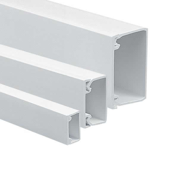

Hi,
I am planning a wall hung TV and at ground level I then have a unit which will house the decoder, DVD player, etc.
There is around 1 metre between the TV and where this unit will be. I am preparing the walls for plastering and would like to know, how I should pass through HDMI cables and have the access to pass any additional cables in the future.
Subject to the construction of the wall; bury a piece of trunking in the wall. Finish it top and bottom with brush plates. If you want to be thorough then add a draw string for use in pulling additional/different cables in the future.
Additional tip: Run power cables in a separate piece of trunking and leave a minimum 9" gap between the two parallel runs. This will help avoid any mains-bourn interference affecting the AV signals.
I am trying to gauge the size of the wider trunking in your picture and is that definitely suitable to bury into plasterboard and plaster?

Now before we get too carried-away with the world of science and the internet and the information it carries I'm afraid I'm going to have to bring you back down to earth with a bit of a bump. :( Not everything can be handed to you on a plate. Occasionally you have to think about stuff yourself. Sorry, but them's the breaks. In the case of this discussion amd your installation then you might actually have to make some judgements and choices about the depth of the wall space you have to play with and what size of trunking would be the minimum acceptable to pull a HDMI cable or similar through if there's already some cables in the trunking.

The trunking needs to be large enough to get the connector through. So if you are just running a HDMI, a network cable, then 40 x 40 will be fine. I personally find that its easier to pre-lay the common cables and then add some trunking with string in for anything else that comes along. You tend to find that as the technology changes, so do the layout options. A few years ago having the devices under the wall mounted telly was the way to go. my telly now only needs network and aerial, as everything is network based.
There wont be one magic answer here as you can lay anything from 1 or 2 cables to half a dozen, different types and the length of run will also affect how easy it is to pull through.

That's just the point, there is no single answer. As motorbiking and I both said, it depends on your particular situation. I have done installs where the TV had nothing but a power lead and single HDMI. On the other end of the spectrum there was an install once where I laid in 3 HDMI, 1 x TV coax, 1 x Sat coax, 3 Ethernet, two power leads, an Optical, a composite video, a VGA and an RGB SCART.
