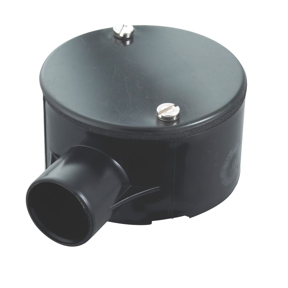

That “entry” you link to isn’t to enter a building with, its to enter an MK masterseal back box!
I hadn't clicked that link.
btj - that is basically a grommet - here's a better view of it:
If you decide to go for external runs of cable without conduit, they should approach the holes in the wall from below, which may require a loop of extra cable. That way any rainwater running along the cables isn't delivered to the hole/grommet/gland/whatever.

I've run some cat 5 externally in 20mm conduit where an internal route wasn't practical.
Didn't use any conduit through the walls, but used these
ae235
where the cables exit the wall. I've since run an extra cable through without too much bother.
