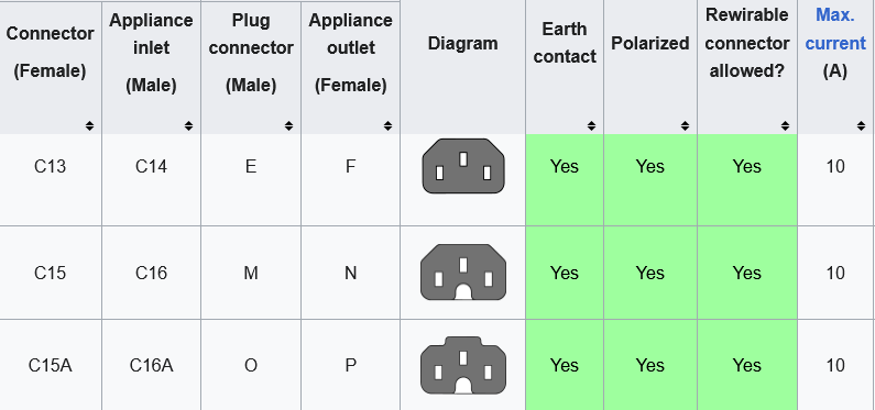

I would swap for a 3 amp, as you point out, only rated at 10 amps, but fig of 8 plug rated at 2.5 amps, and I would not worry about fitting a 3 amp fuse in that, so can't really say must be swapped, it is up to you. This
Lists the connectors and the C15A and C16A are the standard used with kettles, so one can hardly fit them with 10 amp fuses, so would not worry too much.

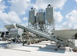

I often wonder about PAT testing, or the inspection and testing of in service electrical equipment. It this one item 1741910270956.png? It is portable. The one I worked on came in one 22 articulated wagon loads.
I had to attend a good deal of health and safety lecturers, and we would be told things like we should not use any equipment which does not have a PAT test label, and taking pleasure to show how he should not use the TV he was using to assist his lecturer as the power leads had no label.

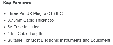

and really you have no idea of the cable size, the advert with this picture said
so this lead designed for 5 amp it seems. I know in my house I have loads of these lead sets, and also fig of 8 leads

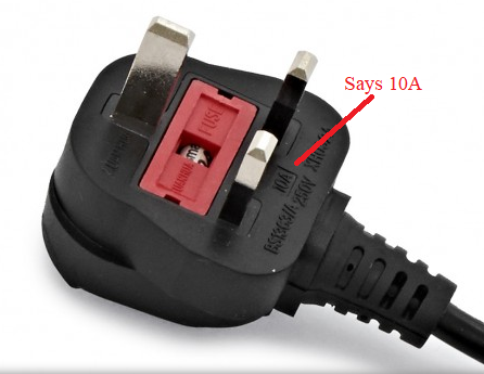

and they swap what being used with many times. c7/c8 and they as said rated at 2.5 amp. There is often a clue, 1741911614626.png this one says 10 amp. But I would carry two fuses, 3A and 13A, I know there are 1, 5, 7, and 10 amp as well, but I don't carry them around with me.

You say the connecter is rated at 10a but no mention of the plug rating, most moulded plugs have a rating embossed on them, usually 5a or 10a and occasionally 13a.
1 would not expect the fitted fuse to exceed the plugs rating.
