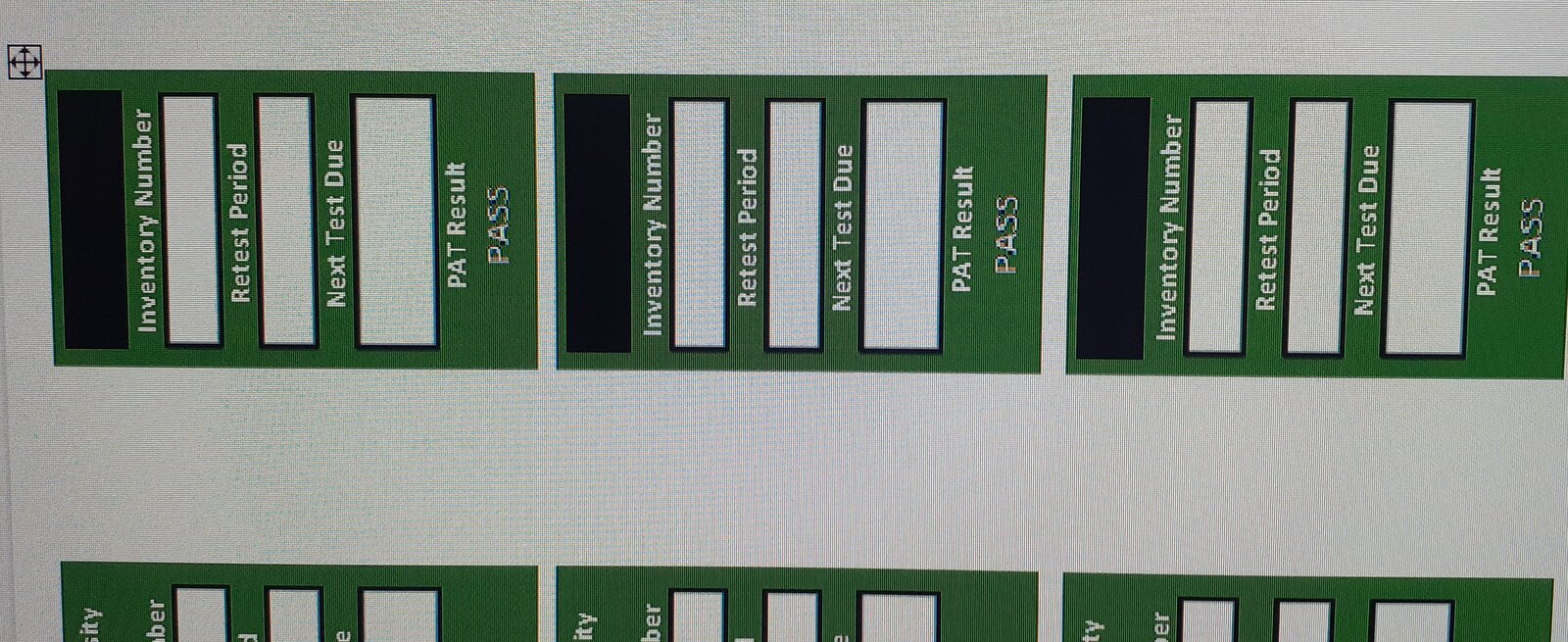

I had around 16'000 assets in my database - we have been using Seaward downloadable testers for 20 years - and they've worked well.
There may be other, better choices out there, but due to the legacy in my workplace, we will be sticking with Seaward.
However, their PatGuard software is now sold on an annual subscription basis, which stings!
I would assume something barcode capable would be helpful when it comes time for a retest,
We originally bought barcode readers for our Seaward Europa Plus, but we rarely ever used them; this comes down to how our appliances are inventoried.
In our case, the appliances have an existing 5 digit inventory number - as the test options are chosen from button presses on the tester, it's far quicker to keep your hands on the keyboard and enter the digits (I can touch type on the Europa plus!), than to remove your hand, grab the scanner, scan the code and replace the scanner.
Thinking about your labeling may influence your decision here.
Also with the 'Pass' stickers - a PAT contractor may print out a new pass sticker and test number each time they test. Whereas we (with access to colour laser printers) print out a sheet of labels (Avery L7160) and they remain on the appliance for many years.
A simple date sticker (L7656) is stuck over the top, to indicate the retest date.
This may sound complicated, but it saves us a decent amount of money over the cost of the printing tapes from the PAT testers themselves - a cost that would usually be passed on through the contractors pricing.
I hope that make sense? :)

Thanks for that, all most helpful. We had been wondering about printing out our own labels on one of our big colour copiers. Also interesting it being faster to use keypad over a barcode. :)
Yes, nothing wrong with that.
We used to have labels supplied by our safety division. They started charging for them, so we simply duplicated what they made on L7160 labels...
Names blanked to protect the guilty! :)
...it's also particularly handy that printing consumables come out of the administration budget! :whistle:

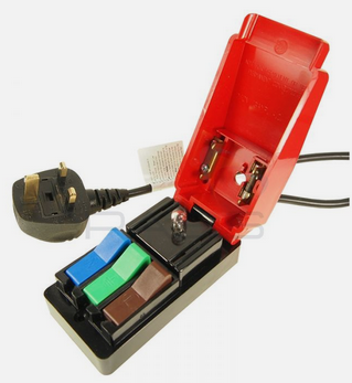

We use a Megger PAT420, I like it but you have to be familiar with it to not get frustrated by it, its got an internal database and its quick to enter an asset number and retest an item (I believe label printer and barcode scanner can be added). I tend to find though that those who only use it infrequently struggle with the searching by number, and you get duplicate items added with sometimes zeros inserted in or removed (i.e. if you use a two part reference, such $group-$item, and differnt people using it, sometimes you get some that would enter 05 and some that would enter 5 for five, which is alright, and I can live with as long as they find it again next time and test agaisnt the same record, but often they fail to that and you end up with another instance created with the other way around. Or sometimes they ignore it completly and book it against name or initials.
I have found that the database (which can be copied onto and restored from a USB stick) is an SQLlite database and there are tools to do manual operations on it on a PC, but it is a pain to do any serious tidying up this way, there are libraries for the likes of VB.net to work with it, so something could be written to assist with tidying it up, it would be better if I could manage to train folk to use it properly, but I imagine thats probably a bit of a forlorn hope, what do you think @RandomGrinch ?
