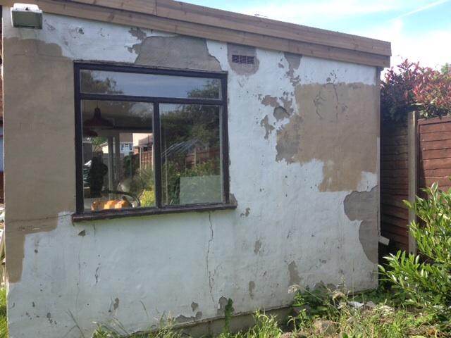

I've recently renovated the inside of an outbuilding to purpose it for storage and my cats to live in while I temporarily live with my Mum. There was a massive damp problem in the building, which I've tried to combat. However there is a lot of damage to the exterior render, which can't be helping keep the building damp-free. While we have better weather, I think it's times to fix it.
I've done some research only to be very confused. The garage rendering is fine on 2 walls, then on the more weather exposed, it quite patchy.
What should I be using to patch it up? My original thinking was to pull off any loose rendering, then patch it up with this: http://www.screwfix.com/p/cementone-general-purpose-mortar-5kg/36857 as it does say its suitable for rendering.
However I have read varying recommendations on using waterproofing before or after rendering... I'm a little confused about this. Ideally I'd like to make sure no damp gets back into the building! As there are bits appearing here & there.
Its not just a case of "patching" it up.It needs a lot more work than that you need to knock all the old render off put expanding metal over the cracks give it a good scutting with SBR mixed with cement and a bit of sand then scratch coat it then top coat it thenrub it up.And l expect it is only one brick thick so l would put some polystyrene backed plasterboard on the inside wall (optional).Then give the outside a good few coats of weather shield paint. If you can understand all this then all well and good, if not you must get a reputable plasterer round to give you an idea of price. ;)
I did say in my first post, that I planned on knocking off any loose render. I understand it's not as easy as "patching it up" however that's why I'm asking here about patching the render. It's only the grey areas on the wall where the render has come away so it's not a big job. The other walls are fine. I'm not paying a renderer/plasterer to come out for less than 2m2 of patching in render on a wall you can't even see from my house.
The internal walls have already been plaster boarded. I plan on doing it myself, hence the post in a DIY forum. I'm not stupid... Having looked on YouTube, I can cope with the ever so "hard" task of patching the render. The original question was about a suitable material to use as online recommendations from "reputable plasterers" seem to be contradictory! There doesn't seem to be an industry standard, which is often the case in the trade it seems.

Hi there. Hopefully i can give you the answer your looking for. I'll start with what materials would be best to use and then without patronising you I can give you a little tip on how I would do the job. All you will need is a mix of PVA bonding and water, and a sand and cement mix with waterproofer through the mix.
Start by coating the area with the pva mix. Then give it a first coat with the sand and cement. make sure you scratch it for a good bond with the second coat. The following day you can pva the area again and give it the second coat. Use a float to get rid of all trowel marks and rub up with a sponge.

As for the info you have given it would not stop the damp getting thru as you have not addressed the cracks that are causing the problems!!!
That could be because they aren't asking anything about cracks. They are asking about the best way to patch up render. Why does everyone try to dig at each other on here?

Its not a matter of "digging at each other on here" but if someone asks a question and we can see that by just "patching" something up isn't going to stop water coming thru as the cracks haven't been addressed then we tell then the right way to solve the problem. Your way is telling them to "patch " over it , which is not going to solve their problem as the cracks will soon come back!!!

I'm not sure what all the other stuff about links etc is about, but don't use PVA for any external work; or areas that may have damp issues.

Should it be coated with anything before adding further render?
