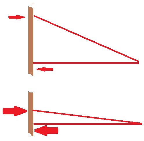

More information needed. Type of awning and condition of brickwork and mortar in the wall.
The weight of the awning creates vertical and horizontal forces on the wall.
The wall will take the vertical forces as they just press the bricks down, unlikely the bricks will crumble.
The horizontal forces from a heavy awning may exceed the strength of the wall.
The top awning shown in the image exerts less horizontal forces on the wall for the same over all weight of awning.
Also consider the effect of wind blowing onto the slope of the awning. That can add significant extra "weight" to the awning.

At least some of the fixing bolts will be in tension. You will be hard-pressed to find 'pull-out' values for bolts fixed into brickwork; completely unknown quantity.

If you are bolting brackets to the wall, it's not just a case of 'will the weight of bricks be sufficient'.
The bolts will be subject to both shear (downward force) and tension (outward pull).
Look at BGs drawing; the top horizontal arrows show the outward pull on the bolts. You could have 1 million tons of brickwork above, but
that would not mean that the bolts would not pull out.
As masonry varies very widely in strength, and as you can never be certain how much resin is actually holding the bolts, and as you cannot guarantee there are no internal cracks in the bricks, there is no accurate way of knowing whether they will resist any defined force. The fact that the bricks are perforated does not help. This is why manufacturers will never quote figures for maximum pull-out force for their products.
All you can do is put in as many fixings as you can, even if it looks like overkill.
