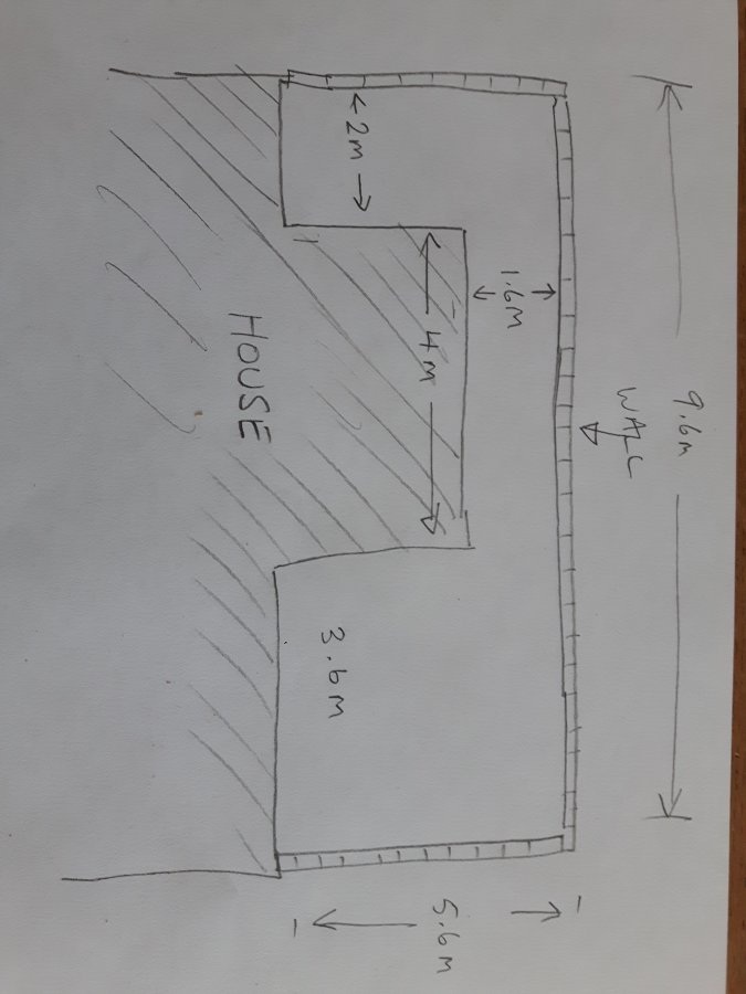

Hi all. I'm building a raised patio, 4 course high, with hardcore and approx 100mm of reinforced concrete fill. The concrete will be contained between the house and wall. Do I need to put any expansion gaps in? I've hopefully uploaded a pic with sizes etc.
Thanks. Nick

I'm not sure about expansion gaps but the reinforcement is unusual, you might want to check/replace any drains you might be covering.
Perhaps I should've given more detail. The concrete will be a level slab for me to lay Indian sandstone with the recommended fall away from the house. Reinforcement may be overkill, but I'm doing it myself, a bit belt n braces perhaps?
There are no drains underneath.
Normal thing would be hardcore then a full layer (rather than spotting) of sand and cement mix about 50mm think.
The reinforcement is a complete waste of time, and the concrete a waste of time.
If you put a movement joint in to the concrete then potentially any movement will show through to the slabs on top. If you dont and it cracks, then so will that.
Cheers both. So, fill it with hardcore and type 1, both wacked? any other suggestions?
If your hardcore wacks well I'd just have that then bed your slabs straight onto 50mm of wet sand/cement mix.
Point up with a wet mix too.
4 courses? So bang on the 300mm limit under PD for raised platforms? Be careful with your finished height- wouldn't want your neighbours kicking off and some clever sod appearing with a tape measure to tell you the concrete is fine but the slabs on top need to go :)

A deep fill of compactible hard-core like that is a bad idea. As long as its restrained on all sides by masonary fill the lot with clean rubble and clean stone. It does not need compacted and will not settle. Lay slabs on a good full wet 50mm bed of 5:1 grit sand:cement.
Unless you can get a vibrating roller on it you will never compact that much to refusal and it will settle fractionally in a year or two.
