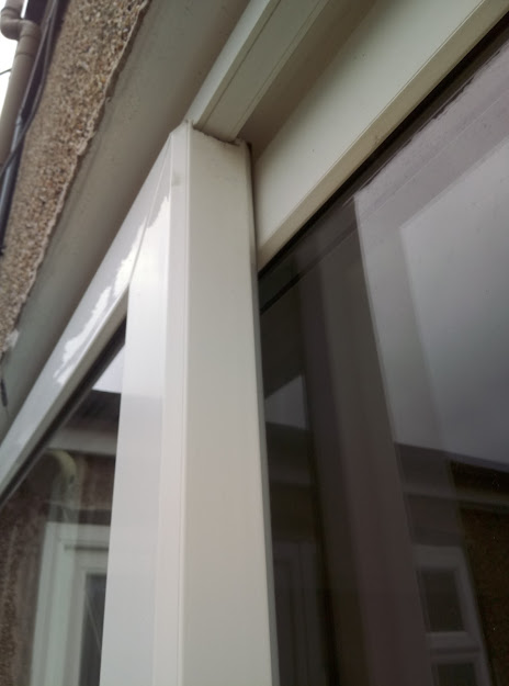

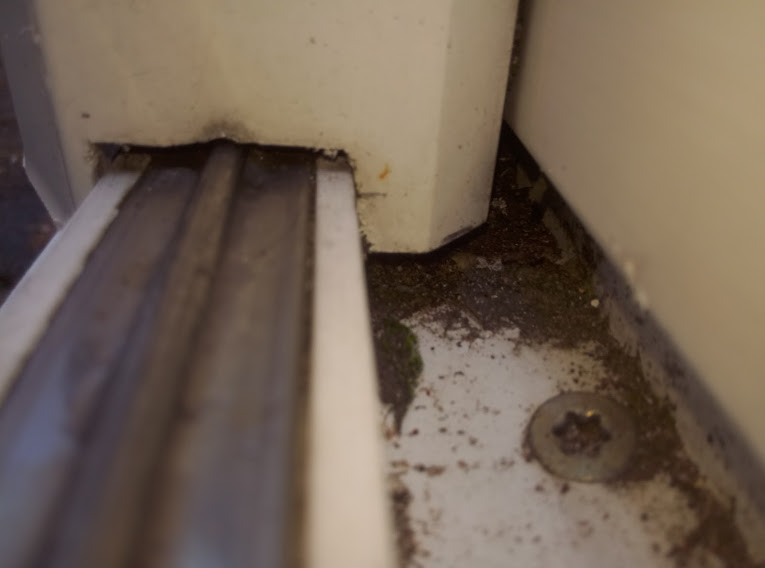

We have a patio door which is lower on one side than the other
On the side where the height is ok I can access the roller at the bottom of the patio door
However, on the side where the height is lower I cannot readily access the roller at the bottom of the patio door
See photos of top and bottom of the patio door, the lower side shown
As you can see there is a PVC plastic cover, covering the side of the door. I expect th roller and height adjustment is below this pvc cover.
How do I get this pvc cover off and on again
A thin paint scraper type tool between the ' plastic cover' and where it meets the sliding door. It's only clipped in. Depending on the make it may have a to be clipped on between the fixed and sliding pane first upon refitting
